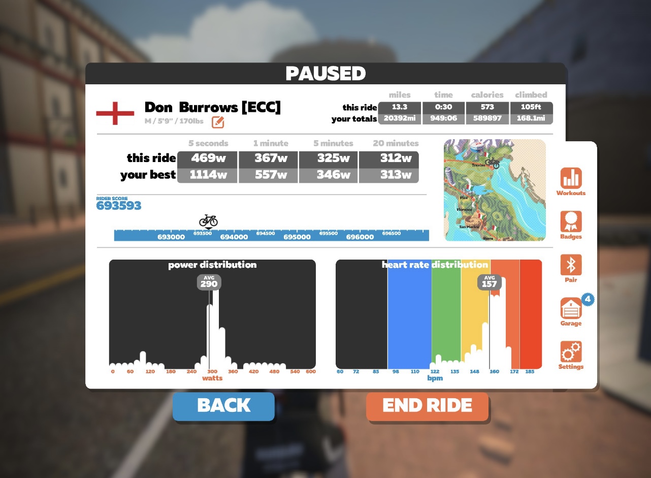

22.Oct. 20k TT, I set a new FTP and 20min power best off 313w

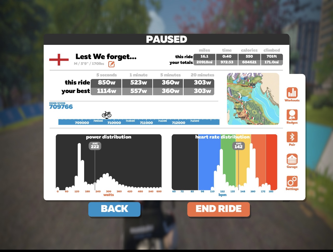

13.Nov. Crit City Race, I set a new 5min power best of 360w, and it was showing a new 20min power best of 303w, which was not a best

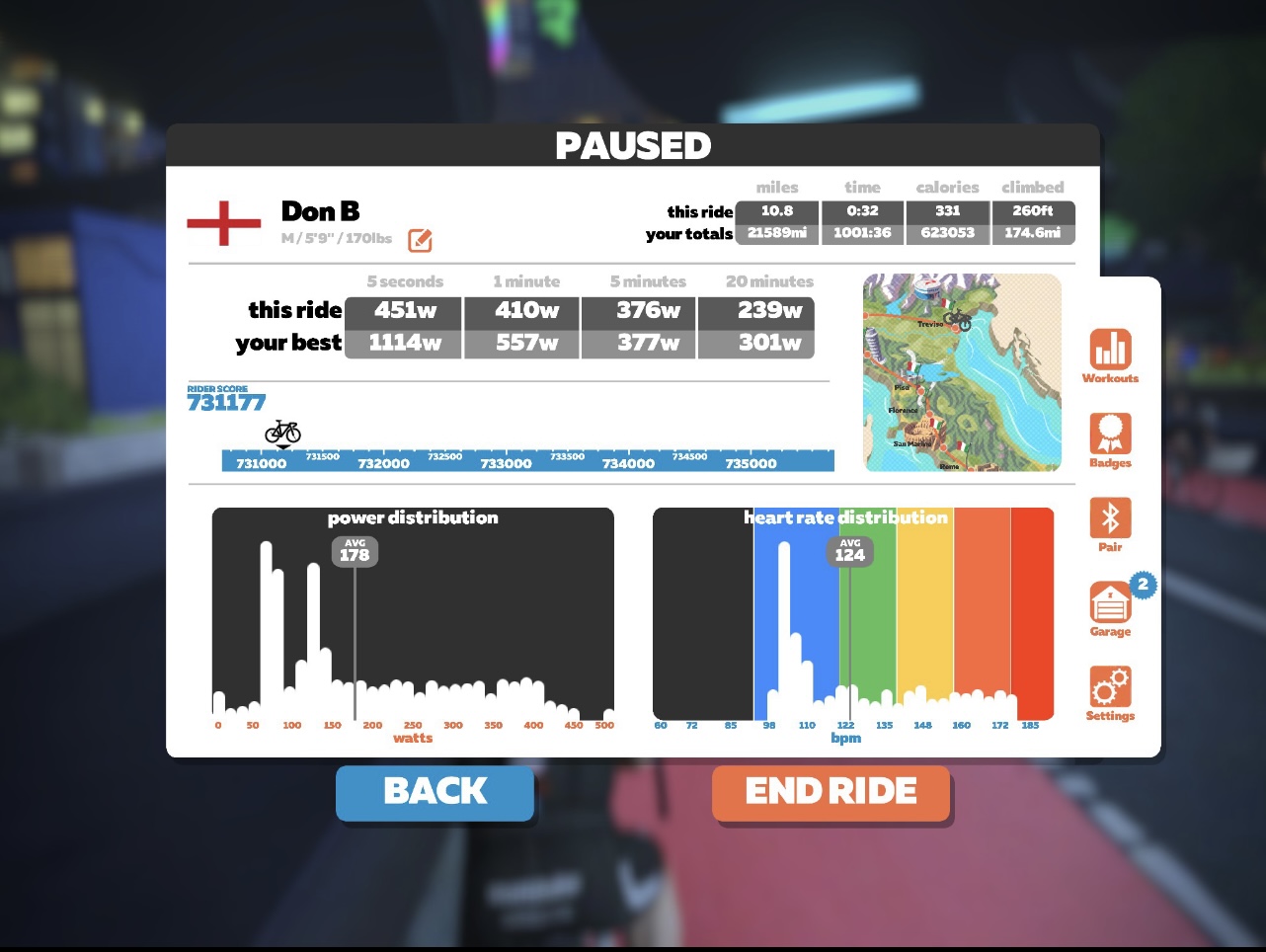

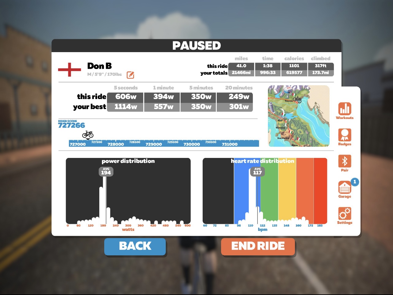

28.Nov Watopia Free Ride, No new bests set, but my bests had dropped again to 5min 350w, and 20min 301w

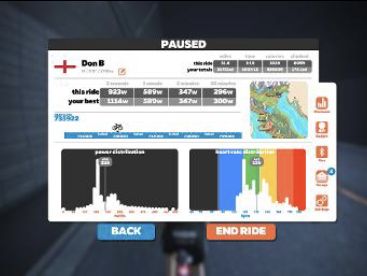

5.Dec. Neokyo Badge Ride. I set a new 1min power PR of 589w, but it’s also showing a 5min PR of 347w, which is incorrect.
