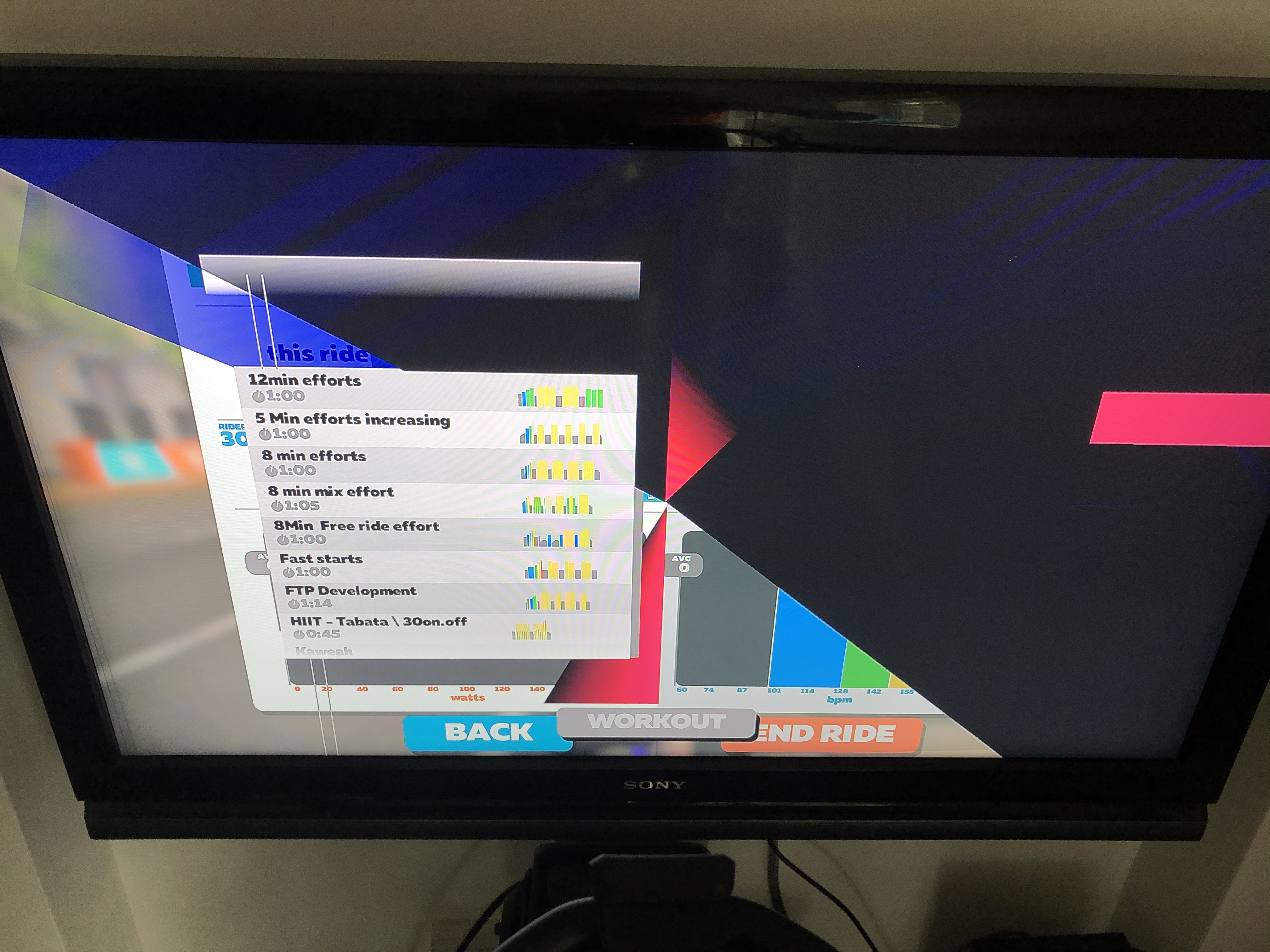

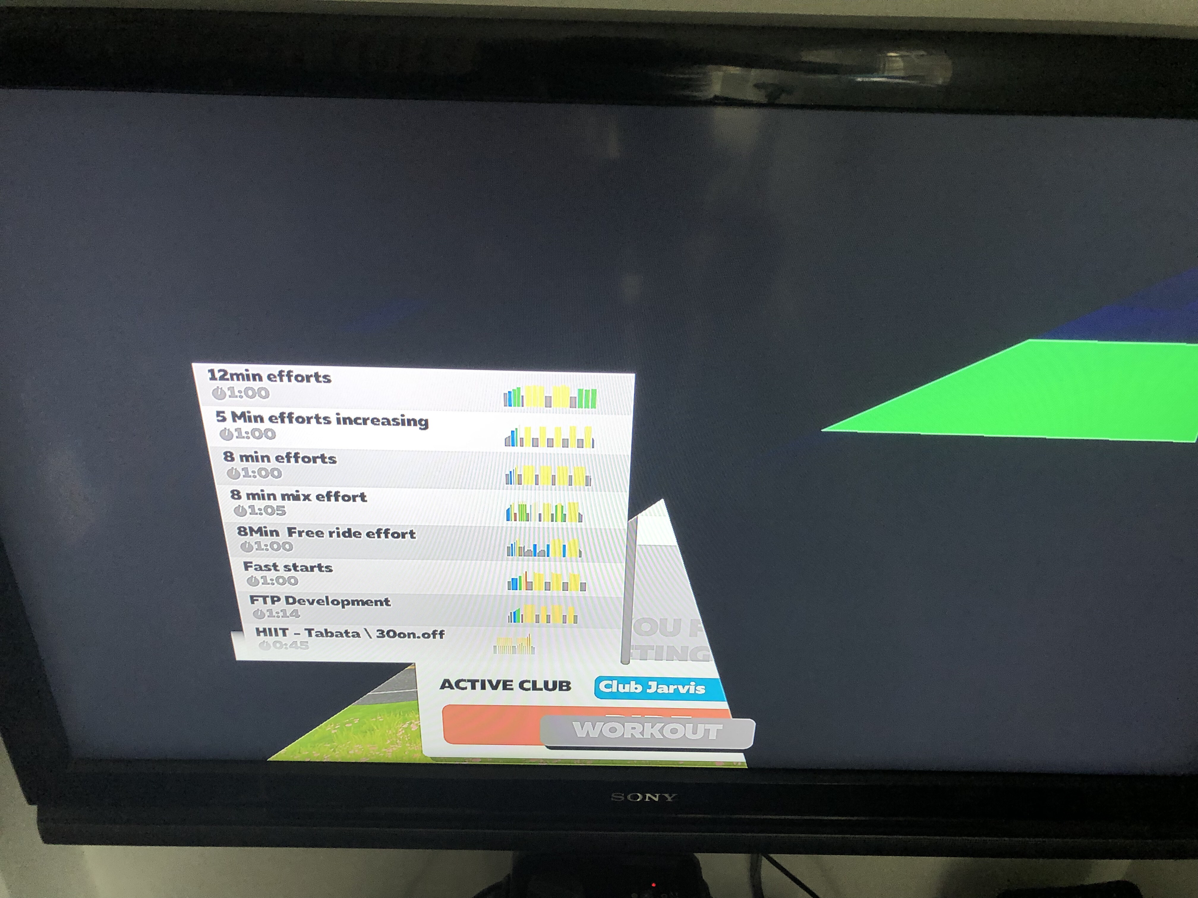

Since the last update I’m unable to pick a work out on Apple TV… zwift crashes to the following screen…
Edit to add - fully updated and once the above happens you have to crash out and force stop the app… happens every time selecting a workout…

Click on ‘Training’ and crashes… Goes straight to the screens in the image… Cant choose a workout, don’t get that far…
