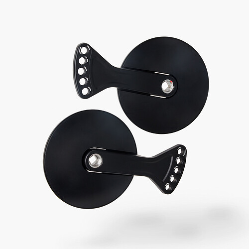

Today, we introduce the long-requested multi-length crankarms for the Zwift Ride smart frame.
It is available as an aftermarket upgrade in the Zwift Shops starting April 16 in these regions:
UK Zwift Shop
EU Zwift Shop
US Zwift Shop
For those looking to replicate the fit of an outdoor bike, these cranks provide options for 160, 165, 170, 172.5, and 175 mm lengths.

Q: I have a square taper crank puller and am a confident mechanic. Anything special I need to know?
  • The Ride chainring is mounted to a proprietary bottom bracket, not to the drive-side crankarm. Pay attention to the Left / Right markings when installing the new cranks as they look identical.
  • You’ll need the following tools. Full installation steps are included in the quick start guide.
    • Square taper crank puller
    • Flathead screwdriver
    • 8mm torque wrench (capable of up to 45Nm).
    • 8mm hex key
  • Prepare the crank puller tip for a square taper spindle. A larger diameter tip for pipe-style spindles may damage the crank.
  • Install the cranks with their pre-applied grease.
  • Finish-tighten the bolts with a torque wrench to 45 Nm.
