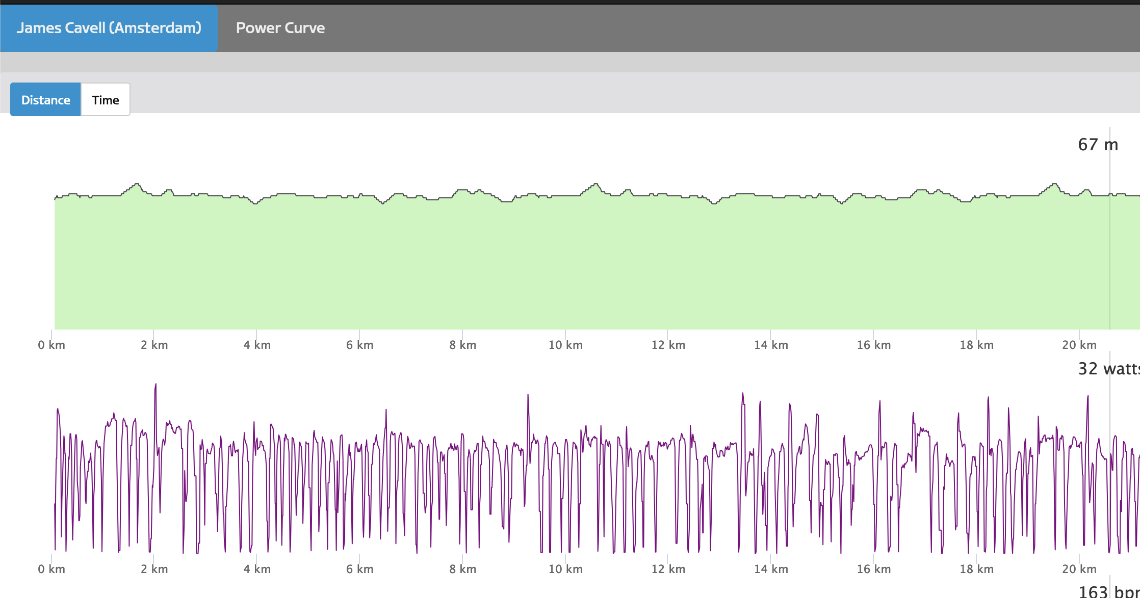

Yeah, my 30s best in a race is 520 (6.7 w/kg / 160% FTP)
But in training it is 732 (9.44w/kg / 225% FTP)
My pedaling style in races has gone to sh*t since I switched from my bike to Zwift Ride, with the 170mm crank length. I feel I’m constantly going from 480-0 over and over again, rather than holding anything constant.
