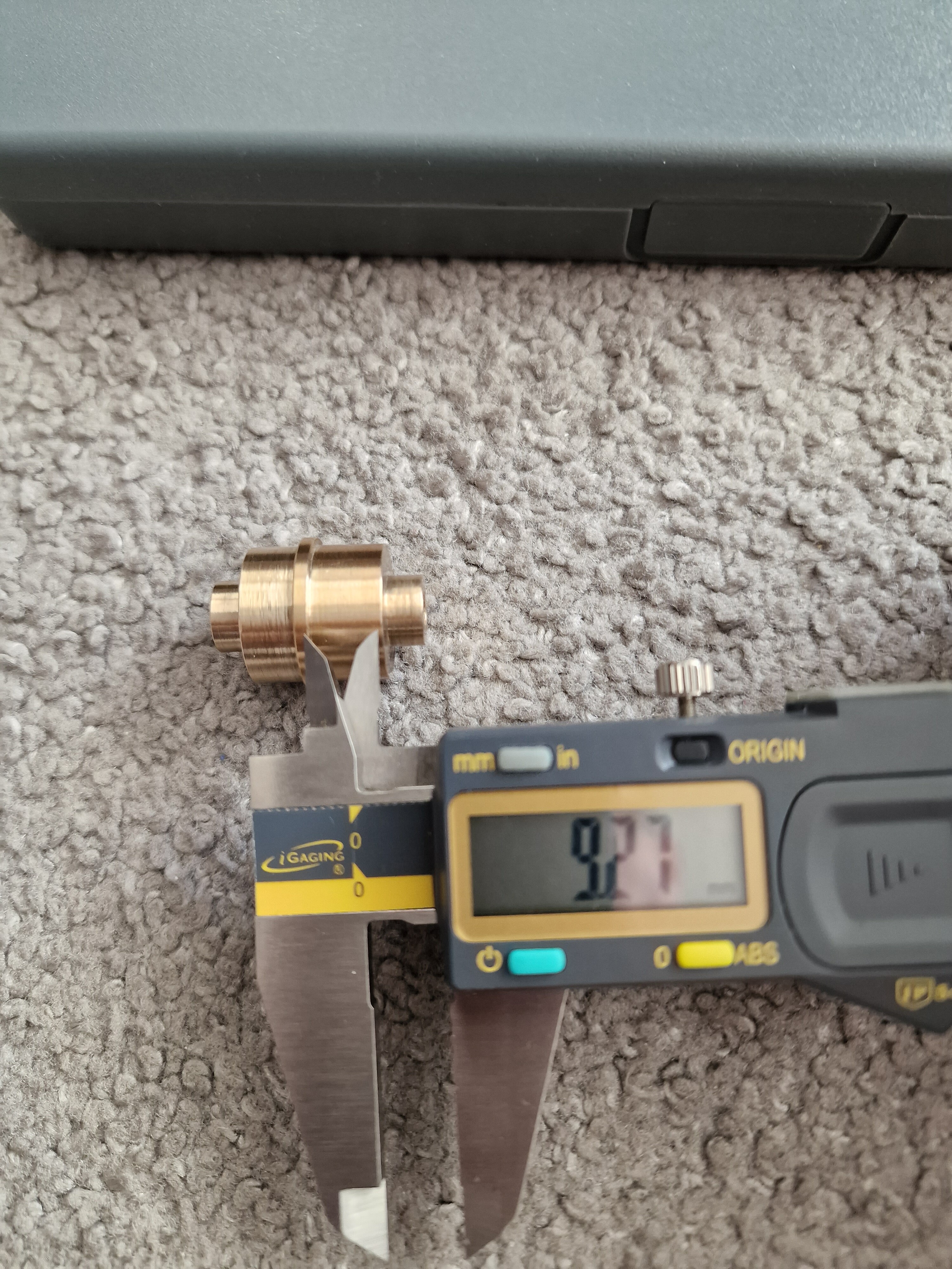

Thank you for your response,
It turned out that my colleague has cnc machines at work and he made the correct adapter for me (your adapter used as a model), on the one hand 135 QR, on the other 141 QR, everything works fine now :blush:

Colin,
I don’t have a CAD file, a friend made it for me during his lunch break :), I’m attaching photos with dimensions, I hope they will be useful
Thank you so much! Really appreciate it! :raised_hands:
Sorry to press upon your kindness once again @Dariusz_Konopka , but is there any chance you could also provide these measurements as well please?
I’ve just realised when trying to create the CAD file that I don’t think there is enough information to derive them, since they look like they have different lengths to each other.
Thanks again!
falsified perspective, left side 4,96 mm, right side 4,96
