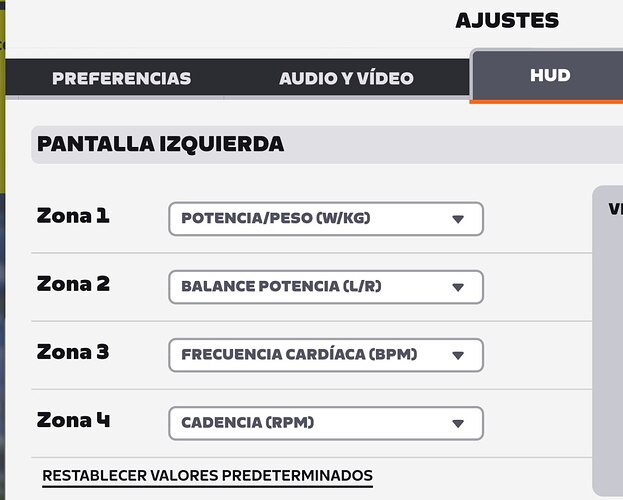

Hi, I’ve synced the Fabero pedals and tried both the left pedal and the right pedal, but the balance on the HUD doesn’t work. Bluetooth mode.
Edit, nope I’m wrong… not a setting you missed

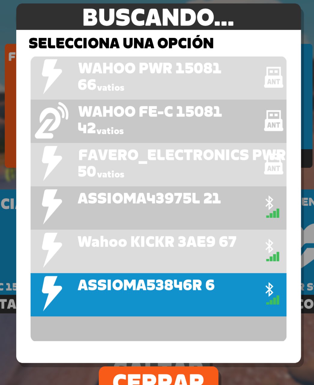

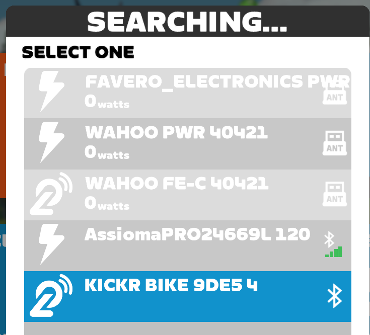

Hi @Jordi_Riu_Popito
Shuji at Zwift HQ. I checked your server logs. Your Power signal is paired to the Favero pedals over Bluetooth, but your Resistance signal is paired via ANT+.
I believe this will be solved for you if both signals are paired over Bluetooth. You can 100% ensure you’re paired over Bluetooth if you remove the ANT+ USB dongle from your computer. Unless you have an ANT-only device like a heart rate monitor, the dongle isn’t needed and will only cause you problems.
