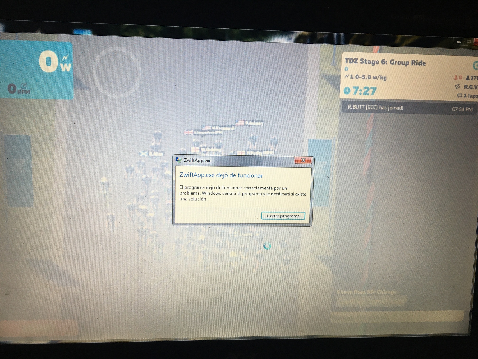

Also i am trying start an event. When i enter to event 3 minutes later crash zwift program!!
What happend???
I use Windows.7 - 64 ánd bkool smart pro
I reinstall Zwift 2 days ago…
