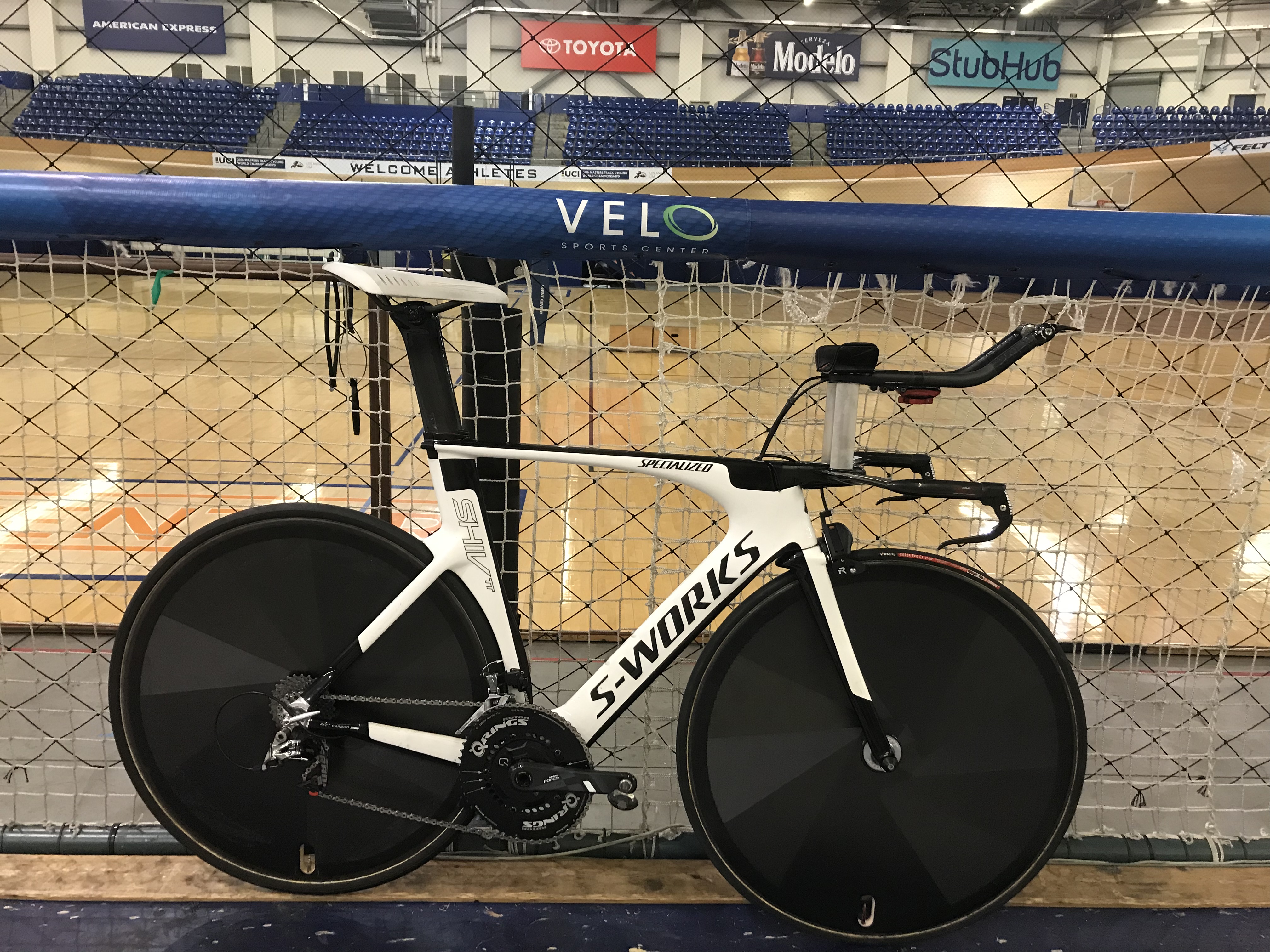

Full stem weight with rider in full TT gear: 81kg
Bike: Shiv TT, Front Zipp 900 w/ Vittoria Corsa cx tubular tire with a slow leak, rear Zipp 900 w/ Bontrager XXX tubular tire.
Rider: ~181- almost 182 cm, POC tt helmet, BioRacer SpeedConcept suit, Specialized Sub-6 shoes
CdA: a slow .223 with the custom 13cm risers. I would be almost offended if my avatar had a CdA of .24 or .27 :joy:
