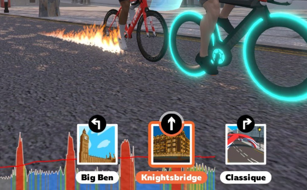

Joe, Yep! Been there, done that. Also: whose bright idea was it to put the manual route selector over the cyclist turn signal? You can’t even tell which way your cyclist is going to turn if you do nothing. And why hasn’t someone fixed it???

I am sure there is a orange border around the option you select.
Not exactly sure what you mean. Could be an issue of differences between platforms (PC versus iOS) or display properties, but I haven’t noticed a problem with the turn signals, pop ups, etc. Anyway, if you do nothing - your avatar will always go in the direction that is highlighted orange by default. More here:

I dis confirm this morning that the turn signal has a orange border indicating what route you will be going on. You will also notice that the circle around the arrow fill with orange indicating the time until
you get to the intersection.
