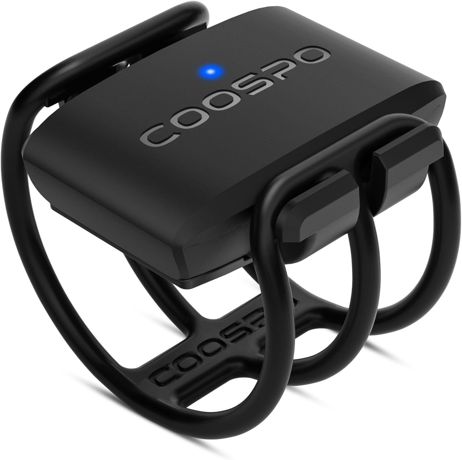

The thing that is weird is the trainer. It announces that it offers cadence but doesn’t send any data. Zwift does not assume that everyone has cadence data and invents a value when it doesn’t get one so that the avatar’s legs move. The cadence targets in workouts will be confounded by this. I recommend getting a cadence sensor. It’s cheap. Here’s an example:
