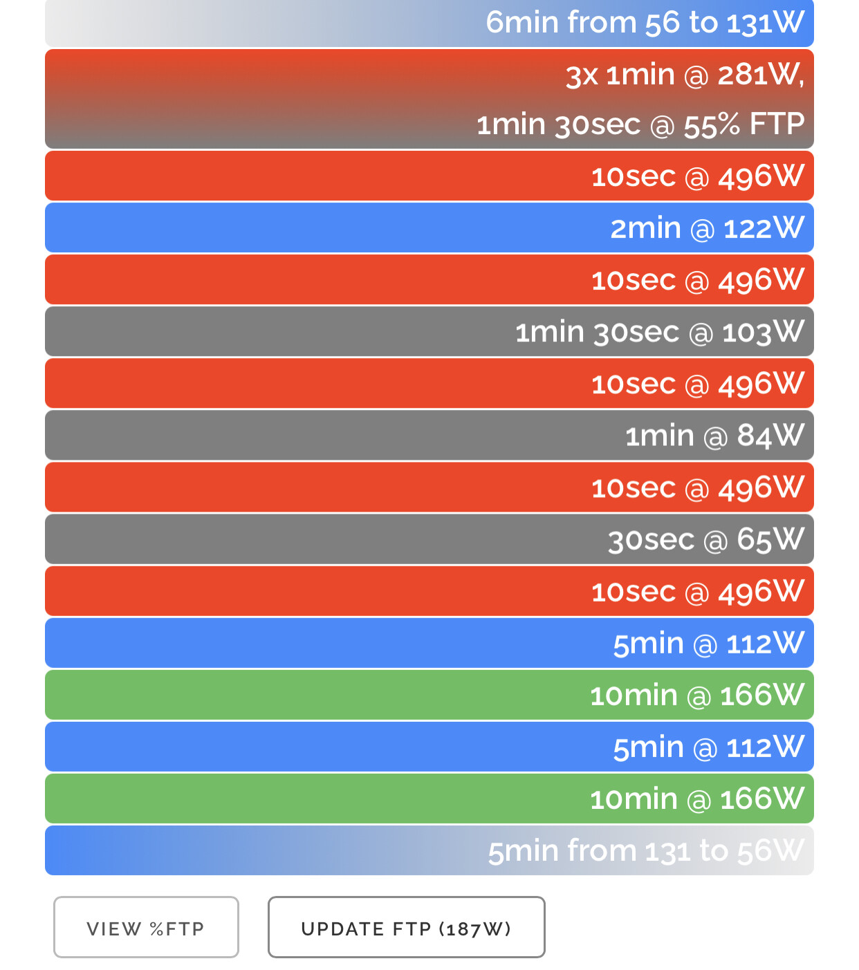

Seems about right (power wise) for the workout. It has a few anaerobic sections that are over 200% FTP. Might be your aerobic system is stronger than your anaerobic and working on sprints and strength training can help out there.

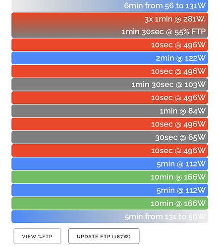

Workout based on your initial FTP of 187
Workout by % of FTP
