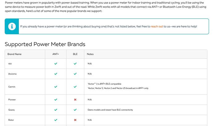

According to this, has to connect via Ant+ for Zwift?
