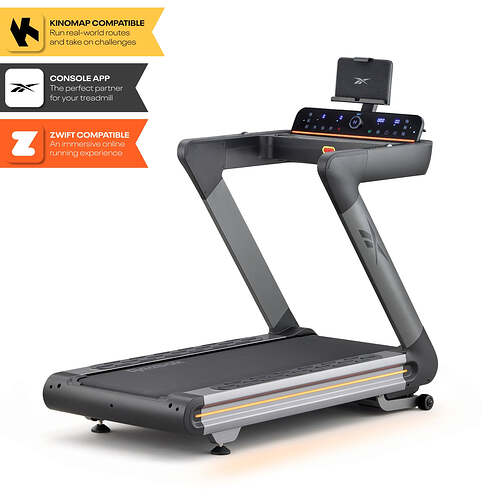

We just received this unit (built and shipped from Sole). On paper it would appear to be ideal for Zwift running on an up-to-date OS iPad. On the device connection screen I have no issue selecting the treadmill (though Zwift isn’t finding any cadence sensors. I thought my Scosche armband sensor had worked for this, in the past…?). I then select a route and my avatar moves, but immediately I have a black connection failure notification in the upper left corner and the app crashes. This has happened repeatedly. I haven’t managed to get Zwift to run properly, yet. I have no such issues on the bike with a Wahoo trainer.

Huh…so it worked pretty plug-and-play for you? Finding any info. re: the actual function of the unit is just really challenging. Had we not been able to determine that it’s actually designed/built by Sole, I’m not sure we would have pulled the trigger. But I love that it doesn’t have a built-in infotainment screen and appears to be designed almost specifically for use with Zwift.

Agree on reasons to buy it, the ‘slim’ front end and lack of screens was the selling point for us.. plus it’s a fairly large deck which doesn’t feel claustrophobic. And the price was very reasonable as it got reduced last week.
