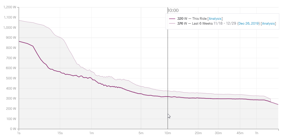

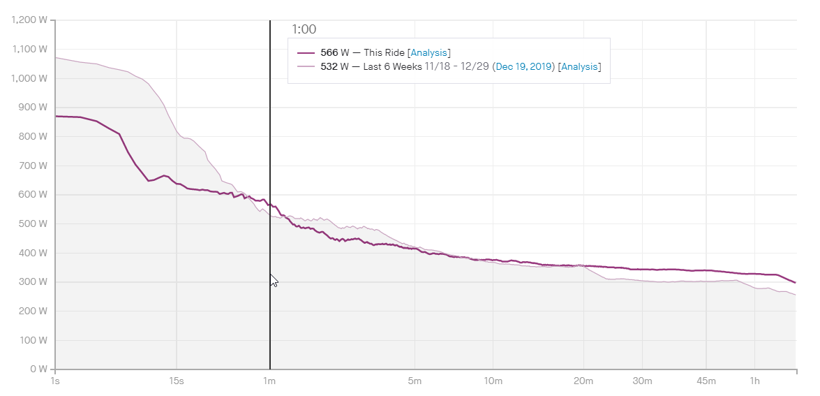

Today I decided to record race on all devices I have: neo + SRM on zwift-pc, android, wahoo-bolt, srm-head. But I suppose that the only comparison from zwift-pc and wahoo-bolt would be enough to show that zwift is totally wrong in result power-curve.
Please find attached image, sorry for the quality - it is necessary to zoom-in to see the numbers, but zwift has is significantly higher numbers than wahoo.

The power-curve is not from zwift - is it from strava - from the same ride: one from zwift, another from wahoo bolt.

3 sec avg cannot create 40w diff in 10mins and 76w diff in 1min.
… and 3sec usually just for display, not for record in fit file.
Well some smoothing is going on if you look at the images.

I do not think that any smoothness is necessary to show power-curve, yes - they are different for zwift and wahoo.
