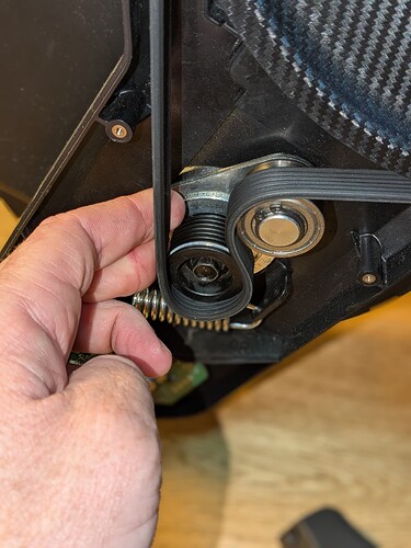

Removing belt:
Remove bike, unplug trainer, remove six #2 phillips head screws holding side plate on, and set aside
Slide two fingers behind belt and begin to pry/twist the belt towards the edge of the flywheel pulley.
While continuing to apply pressure to the side of the belt with your fingers, take your other hand and slowly spin the drive pulley (the big carbon fiber one) counter clockwise to walk the belt off of the flywheel pulley.
Almost off – you want to slip the belt off the flywheel pulley rather than have it slip off the tensioner pulley (bearings) so the spring won’t release all at once.

To reaffix the belt, guide it through the flywheel pulley and around the tensioner pulley (be sure to reinstall the tensioner pulley spring, hooks facing up). Then loop the belt around about 1/3 of the drive pulley and leave the rest slack behind the drive pulley, passing between the plastic shell and drive pulley.
Here’s a view from behind, showing the slack belt looped partly over the drive pulley and then routed down towards the space between the plastic shell and drive pulley.
Last angle from above, showing the routing of the slack part of the belt. Clamp the belt drive pulley where it wraps over the back using finger pressure.
Then, while continuing to clamp the belt where it loops off the drive pulley, simply rotate the drive pulley counter clockwise towards the slack end about 1/3 of a turn. The drive pulley will begin to take up slack and tighten the spring until the belt is wrapped around all pulleys.
View from the front, you can see the spring beginning to stretch as I rotate the drive pulley counterclockwise.
All done!
If there is any misalignment at this point on the drive pulley (and there usually is), just spin the drive pulley the opposite direction (clockwise), and it will usually work itself out. You can also use finger tension to guide the belt (as during belt removal).
Check and verify that the belt is correctly routed through the drive and flywheel pulley groves.
