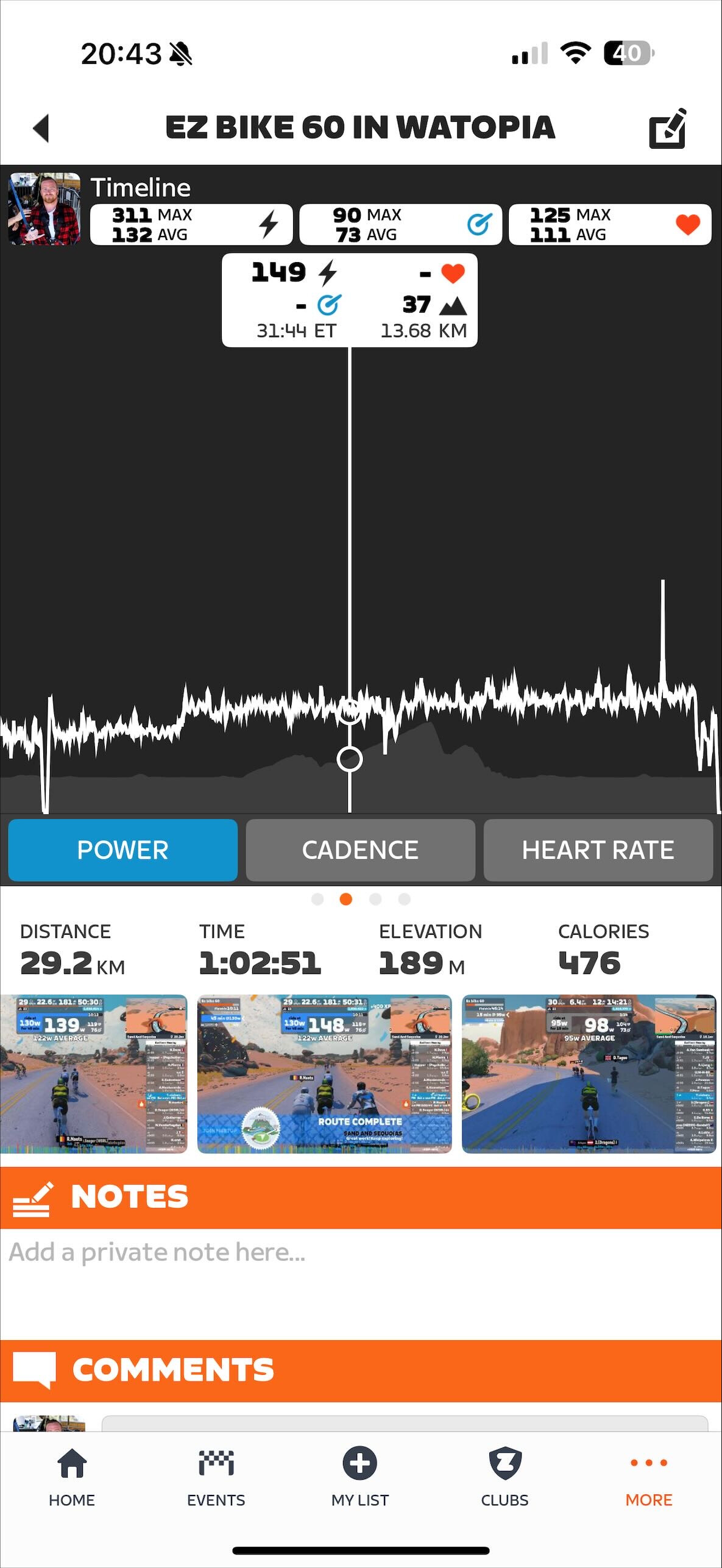

I’ve used Zwift for years apart from in the summer like alot of people - however now after having done s few rides since coming back this time im finding it impossible to stay within target power W zones. I’ve been doing workouts of 95w for 15 mins then 130w for 45 mins. This and when doing an FTP test it was impossible staying to the range - it was jumping from 60 to 300w consitently thorugh this. I tried really hard to maintain the same power and speed and it was really difficult so something must deffo be wrong.
I’ve done the correct spindown checks etc and its still an issue its impossible for me to keep within the range even though i know im not really changing anything and i’ve not had this issue before. If you see my pics the one is from when i started out again this time last year - its clearly within the power W targets but now its all over the place - it could be worse but its deffo not correct it was easy to stay withing the w targets last year.

The super-smooth graphs you see are from people who have power-smoothing as a feature on their trainers. A fair bit of variation is just normal. How fast your trainer responds also impacts how much variation there actually is.
Looking at your graphs though - ERG works best when you keep a constant cadence, you’ve got a lot of variation happening there. Just keep a constant cadence and don’t look at the power and you might get better results.

ERG mode power smoothing is a setting in the Wahoo app. It changes the reported power from the trainer to make your graphs pretty.
