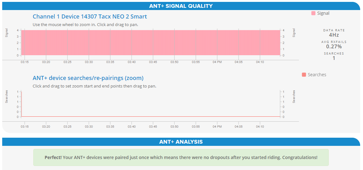

ANT+: A sensor can broadcast to multiple units at the same time. Range about 30m, normally rock solid.
BT: Only a single connection can be made. Range about 10m.

ANT+ 30 m (100 ft) is a theory, the sensors (and most cheap USB dongles) will never reach it!
That’s why the most ANT+ users recommend placing the dongle so near as possible to the trainer/sensor.
That very much depends on the implementation. Sure, it’s pretty solid on a Garmin or similar. But on a PC or Mac you’re relying on a dongle - some people find them very solid while others have no end of problems. This may or may not be due to the very large variety of different ANT+ dongles out there.
Some people will tell you that ANT+ is much more reliable than BT. Others will tell you the opposite. There are a huge number of different factors at play here - different hardware (including trainers), software and radio environments.
I prefer ANT+ personally because I don’t like the exclusive pairing behaviour on Bluetooth, but there’s no right answer as to which is ‘best’ in terms of reliability. Both are on the same general frequency, and many people have joy simply by moving from one to the other.
