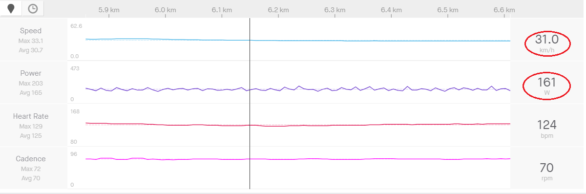

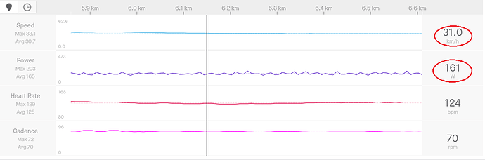

I just checked your last workout, your screenshot show 21mph (33.6km/h) @ 162w. That is in the same ballpark as my ride on a flat road.
