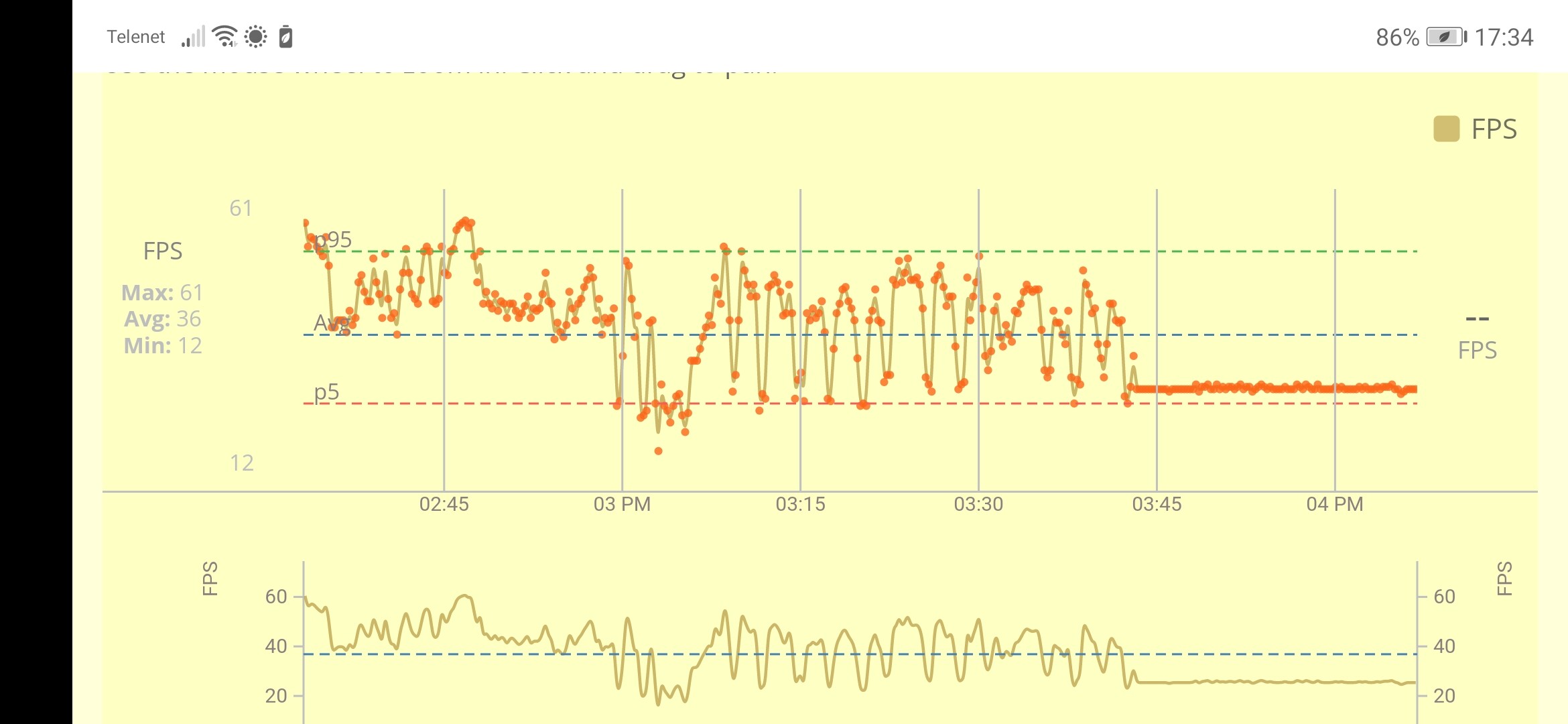

I just tried Kurt’s log file and it failed on Zwiftalizer too. Tried shortening it by dropping minutes off the end, and did the same on one of mine. Mine was fine, Kurt’s not so much. Only difference I could see was mine are double spaced, Kurt’s single. Odd.
Thanks Kurt. It should be working now. I will try to address the incorrect platform icon and ‘unknown’ CPU some other time.
