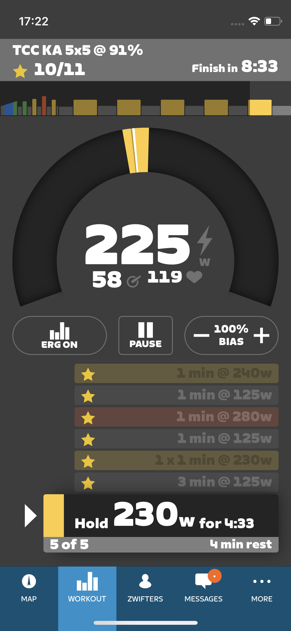

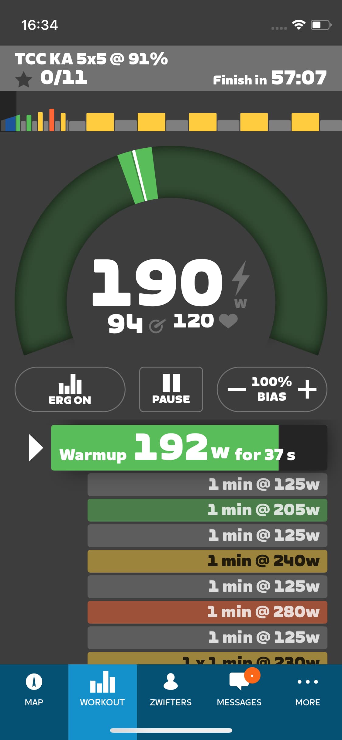

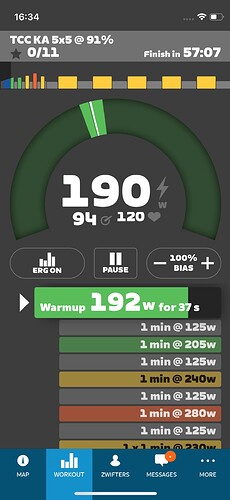

What is interesting, it seems that ZCA is calculating the correct power numbers in workout view.
Warmup:
91% FTP = 250W*0,91 = 227,5W
The target should have been 228W or rounded correctly 230W. But Zwift said 225W. :man_facepalming:
Its correctly displayed in workout view, but only for the actual step. All other steps are rounded. The actual power transmitted to the trainer is a rounded value as well.
