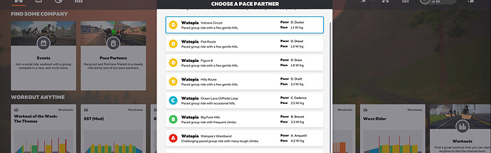

How do you access the pace partners? Is it a selection under training?!?

It depends on which version of the home screen UI you have.
On the old version, you select at the top of the screen which world you want to ride in. Currently, if you select Watopia (always available) or Makuri Islands (only available certain days), the Pace Partners (PP) block appears towards the lower section of the screen. You click on that, select the PP that you’d like to ride with, and then (from my memory) click on ‘Ride’. The world loads and you’re transported to the group that’s riding with the PP, aided by pedal assist for about ten seconds.
In the new home screen UI, the PP tile is always available around the top row. Clicking on that, you get all the options. (At the moment, Makuri Islands PP are also permanently available, even if Makuri isn’t a current guest world.) The process is relatively similar. You might find that there are more people riding with Watopia PP than the Makuri ones, giving a greater chance of getting a good drafting opportunity. The great thing with the PP is that you can pick a faster/more powerful one on days that you’re feeling stronger, and slowly be able to ride for longer at the more demanding pace.
