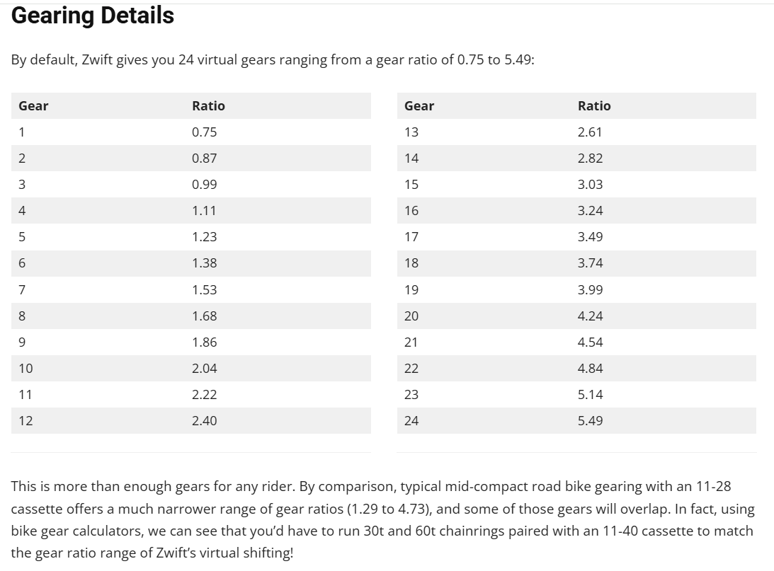

Good question and I don’t claim to have an answer. This ZI article seems to suggest that you should be able to achieve an equivalent high gear of real bike to having a 50-tooth front chainring and running in a 9-tooth rear cog.
ht tps://zwiftinsider.com/virtual-shifting/

In this article, just below that gearing table, there is a section called ‘Customize your shifting’. This indicates that there are options in the GUI to chenge the vrtual gear setup. Maybe you’re not set for a 39/53 front equivalent?
