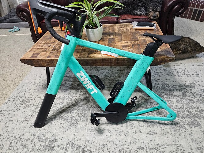

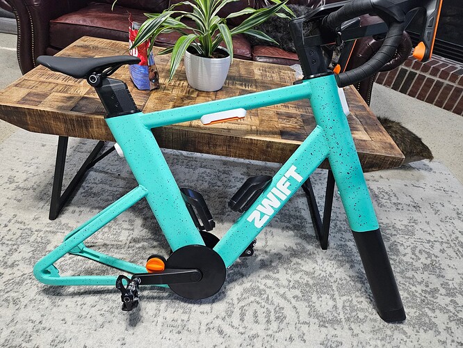

My Kickr Core is out for warranty and I was not a fan of plain white so I used the down time to change the color of my Zwift Ride.
I vinyl wrapped mine with car wrap off Amazon.

I left the “ZWIFT” logo in place while painting, then peeled off after painting. The other stickers were small and came off very easy and applied back on just fine.
Thanks Nathan. Ive just managed to create a vector file of the Zwift logo myself, so im hoping to get that made in a red/yellow oil slick finish to go over an orange candy paint job.
In terms of frame prep - what did you do?
Im painting with spray cans, was thinking a general light sanding using 320 grit wet & dry would be enough to give the first coat good grip? Im going to put down a layer of silver base coat and then the orange candy on top.
I did a light sand prior to painting, 320 may be what I used.
I completely disassembled the bike and taped off bearings. Then sanded between coats. This was a multiday project for me, but it turned out really nice.
