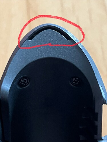

This tiny gap seems to be the problem:
That’s where sweat can get in and cause trouble on the steering/braking/vshifting circuit board. There‘s even a little drainage gap at the bottom to allow sweat to escape (can’t think of another reason for this gap):
