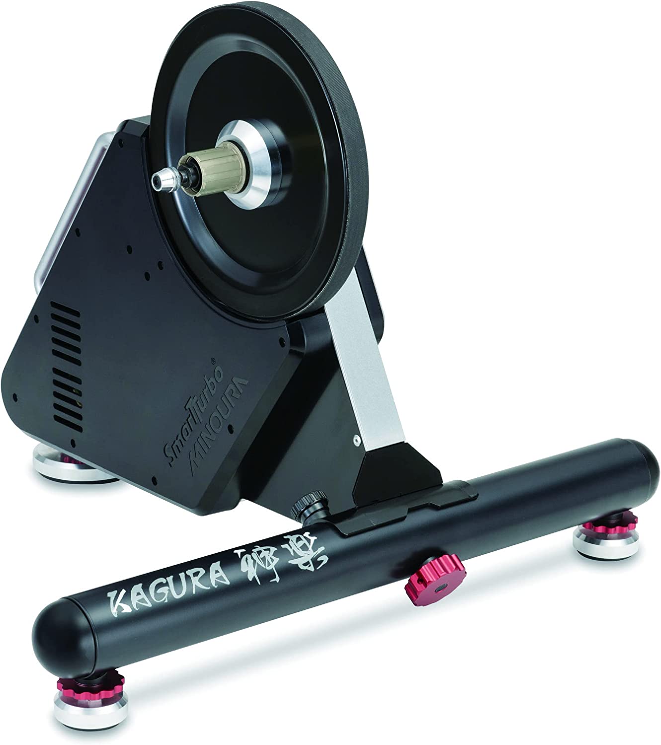

On another note… Minoura has been around for a long time, why on earth do they not have a modern direct drive smart trainer? You’d think they would want to keep up with the current market… maybe target that Kickr Core/ Zwift Hub market…
oh, interesting, I couldn’t find that when I looked on their website, I must have been on the Canadian site.
Maybe for the Japanese (or at least Asian) market only?
Seems to be available in the US for $599
