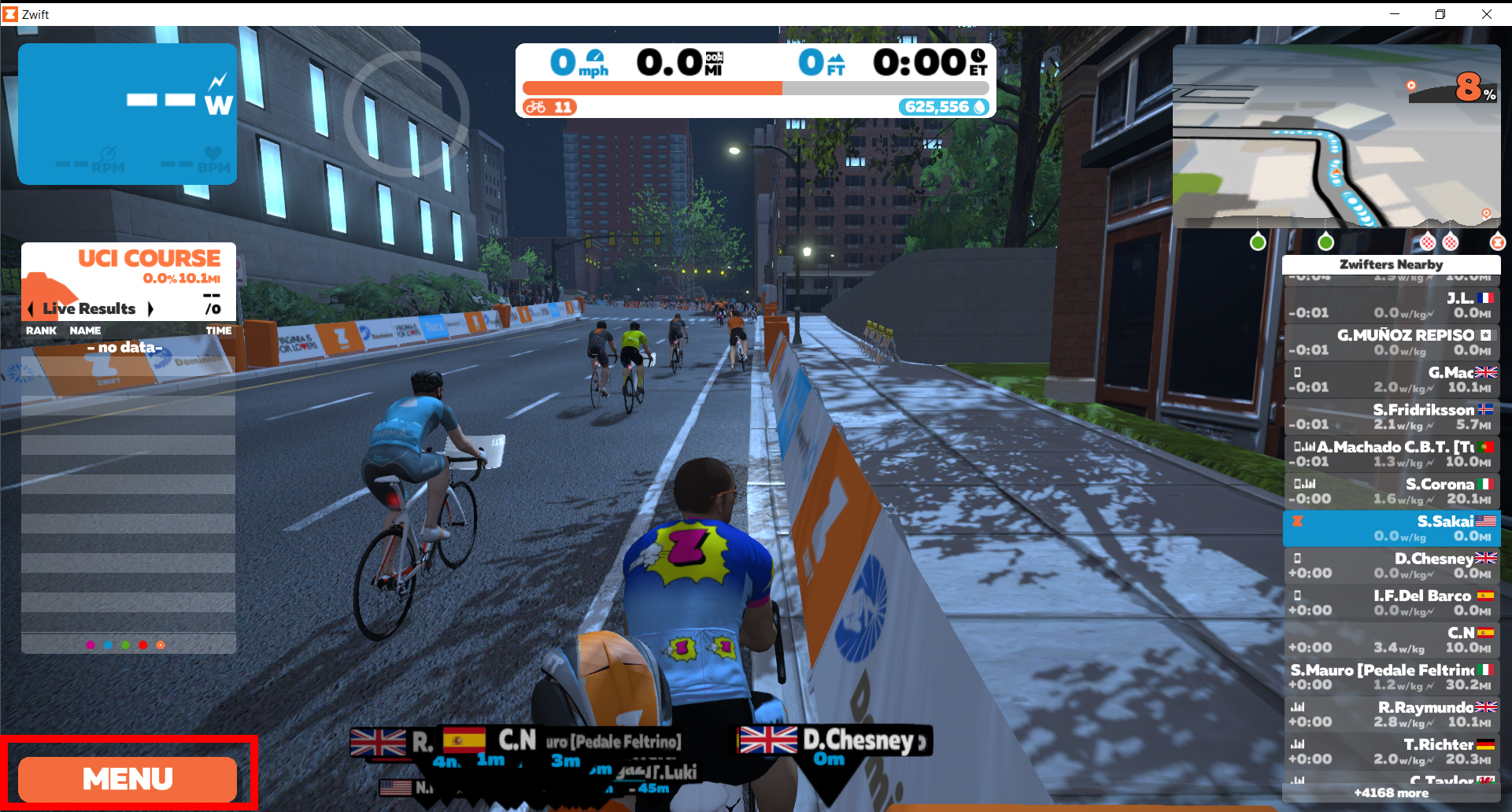

Please check the number set in Functional Threshold Power (FTP) setting in the game app, under Menu / Settings. These screenshots are from the Windows game app:
Step 1:
Step 2:
Step 3:
If your number is too low, you will have all those symptoms. What’s the number?
FTP is a measurement of your physical abilities, and it’s very different from person to person. You might try manually entering 50 to begin, perhaps double it 100 to see what that feels like to start. This is a quick way to prove if this diagnosis is correct.
A more accurate way to set your FTP is through a proper FTP test, and one of the methods explained here will be the best way to match your true physical abilities.
