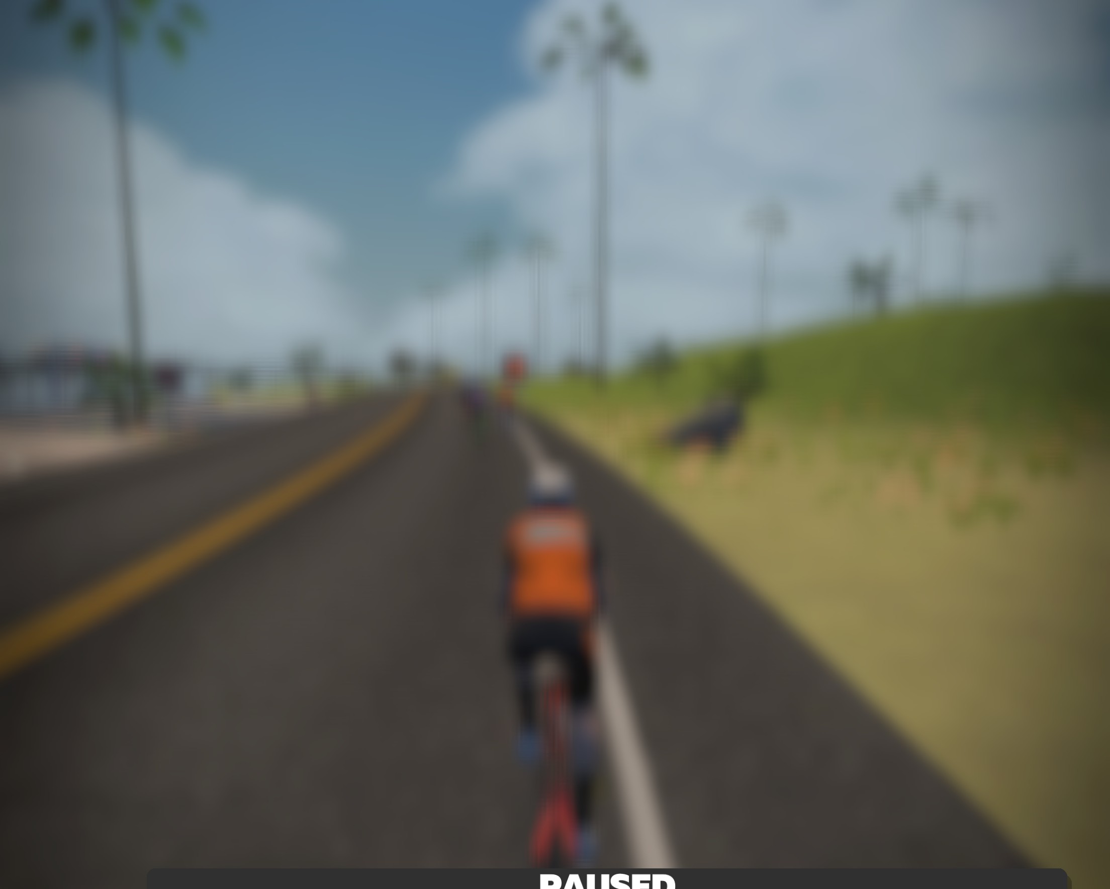

Hi have the fold 3 and when I open zwift on the small screen it works fine but if I open it on the big screen it doesn’t show properly and I have see a half of pause button with a misty screen

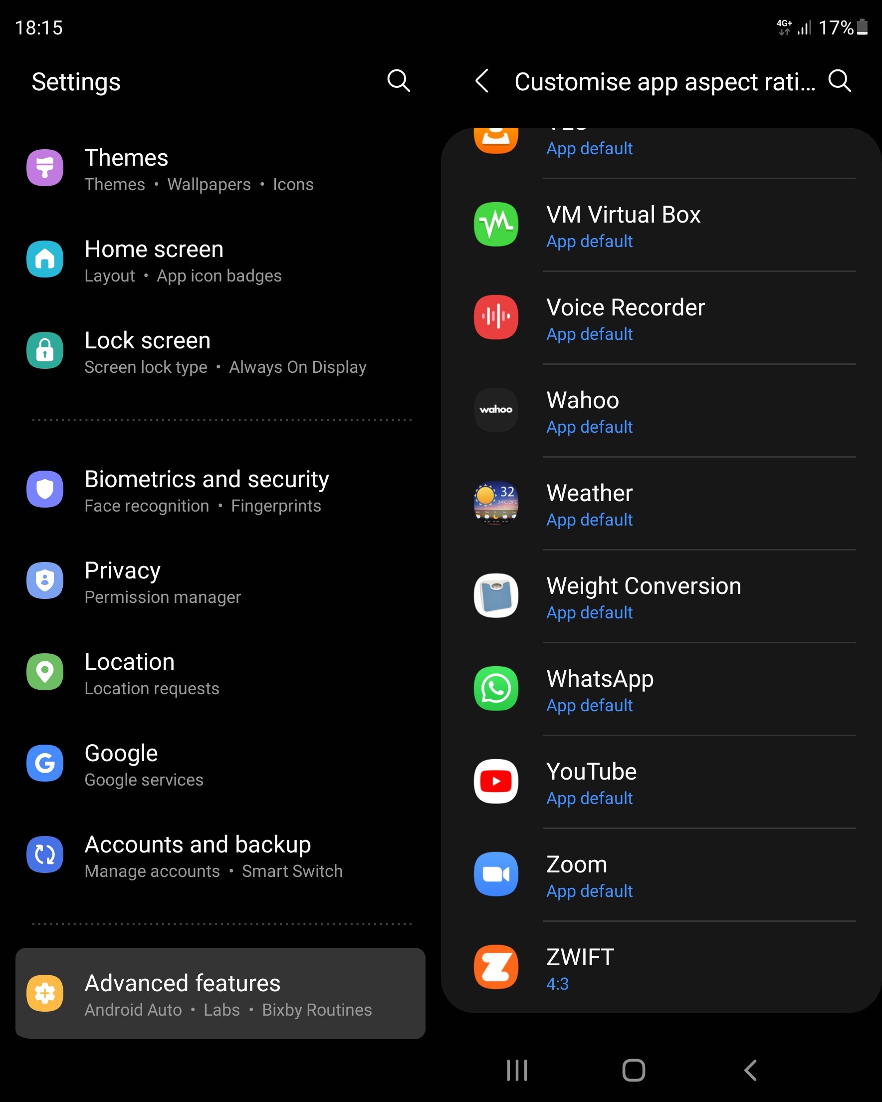

I know this is a bit old…but in the labs setting, forcing an aspect ratio of 4:3 fills most (90%+) of the screen and I don’t the paused message.

Thats weird, I’ve set mine as follows:
And it looks like this on my phone:
I only get the wide screen on 16:9 I don’t get the book look nor any other view and don’t get it covering the screen only partially displayed?? Anyway it’s a start better than nothing, thanks again for your reply
Yes it’s a really interesting one, and frustrating because we know it can be done! I think it might be because you have the navigation buttons active. I changed mine from swipe to buttons and got the same issue “Paused” issue even in 4:3.

Yep sure thing, if you search for navigation bar in the settings you should see something like this.
I think you have buttons selected, where as I have the swipe option enabled. This means it doesn’t show the buttons on the screen and I just swipe up from the bottom where the button should be to trigger it.
I could be wrong but I think having the nav buttons visible is messing a bit with the resolution of the screen.
Excellent, it’s working now so the swipe keys obviously is a main player in deciding??

Anyway, I had a heap of updated pending on my Fold 3 which I finally installed yesterday. After doing so, the way Zwift behaves changed on my phone. Whereas previously setting the custom aspect ratio to 16:9 meant Zwift ran in the middle of my screen, using about 70% of the display, when I went to open Zwift this morning, I could immediately see Zwift was “stretched”. The Zwift logo was wider and it didn’t look right. It still worked in the menus, then when I entered the game I get the blurred screen and “Paused” writing and I can’t do anything. Changing the custom aspect ratio to “Full Screen”, 4:3 or App default does the same. Menus work fine, the game itself doesn’t. In fact, the only way I seem to be able to reliably run the game is on the smaller front screen! I am guessing this has something to do with the updates I just ran, but not sure how to fix it.
