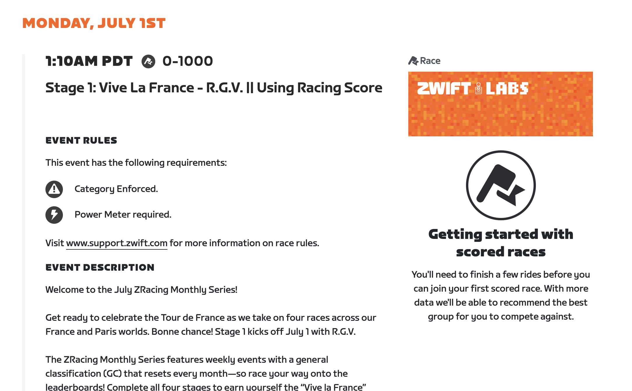

If we don’t have quality 90 day power data for a Zwifter, they will not be able to sign up for a racing score race at all until they do other activities to build up their power profile. In this instance, the following will display when trying to sign up.

I won’t share the full details of the model here, but as you participate in test events and get a feel for things, please let us know if you have any feedback! We built the system to be tune-able in a number of ways, so we’re ready to make adjustments as the feedback rolls in. Now that the seed scores are visible and event sign ups are available, we would love to see any feedback related to those elements.
