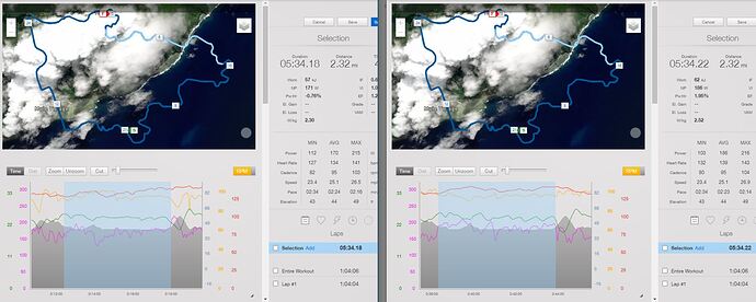

It wasn’t so much that other riders were passing me - I had to hold higher w/kg than them just to maintain position/speed when the group was moving at a steady pace. Check out the sidebar on the right… I know it’s just a snapshot, but I and a few other riders are around 3 w/kg and most others are at or below 2.5 (and I’d been holding ~3.0 w/kg for over a minute at that point). In the same segment on the previous lap, I was able to maintain the same ~40 km/h with ~160w (2.1 w/kg) and my average power was 16w lower.

Maybe the graphs will do a better job of explaining than I am. Same ride (C. Cadence group, steady pace). Lap 1 is on the left, lap 2 is on the right. Same section of road, same distance, same average speed, but average power was 16w higher on lap 2. Unless they’ve added wind to Zwift, that seems odd to me. The only difference I can recall is that the bunch wasn’t packed as tightly on lap 1.
