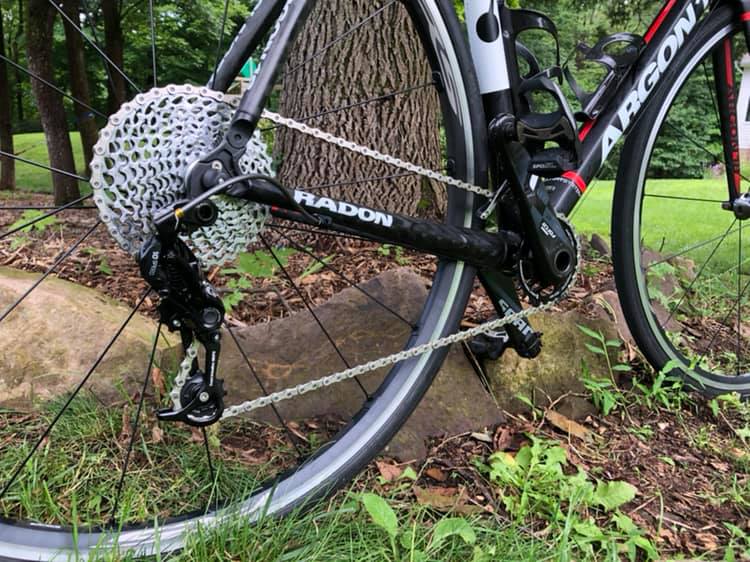

Agreed! That’s why I’ve recently done this to my road bike! :smiley:

That look like a bit of an overkill… LOL

It’s only temporary! :joy:
I did lots of number-crunching and waffling re: gearing and ultimately decided that it’s better to have gears I don’t use than to need gears I don’t have! Except for the very beginning, the hill is relentless. (rarely dipping below 10%, extended sections at 18%, etc). 18% into a raging headwind? I’m content to be able to sit and keep my cadence up vs. use ‘hero’ gearing and struggle to keep 60 rpm for 90 minutes!
[edit: also - my first AdZ effort with the gearing pictured was at an avg cadence of 97 RPM (w/o using the largest cog) and was 1:46 faster than the same bike with 50/34 double (@ an average of 77 RPM). It may look goofy, but that’s fine as long as it’s faster up the mountain! :wink: ]

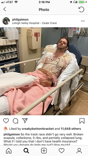

Turns out, he has done that one. I’d just forgotten (or hadn’t watched it).
Phil’s great. He took a really awful spill at my local velodrome last month! Hopefully, he’s recovering well. :crossed_fingers:t2:
