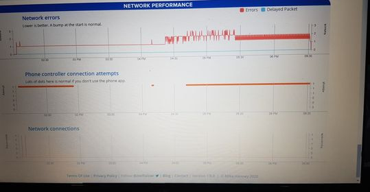

Everything i drop a file i have the same analysis of a ride in august 17th 2017…
What numbers do you see for the last ride with the issue.
I’ve sent you message on Messenger maybe easier to continue?
EDIT: I (Gerrie Delport added the pictures that @John_Deschilder_BZR send me)
I assume those is the images from the ride that gave you problems.
It look like there is some network issues.
Restarting the router and Wifi modem is a good place to start.

thx for the test. seems its not related to connex…
Did you look at you log.txt file in zwiftalizer and you network does not have any errors?

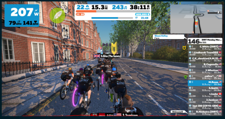

Screenshot from a group ride I did this morning. I didn’t notice anything strange with the draft today, but look at the subtle differences in distance. Leader and myself are both at 15.3 miles, others are ranging from 14.9 - 15.7 miles.
