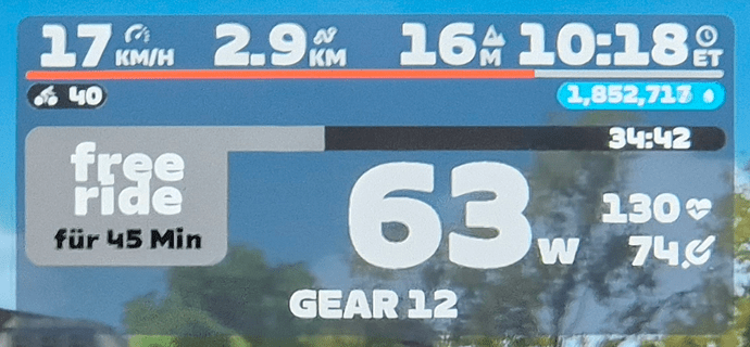

I have an Elite Suito and I’m extremely frustrated with the virtual shifting.
I have found this post here: [not allowed to include links. The number is 653170/6] and it suggests that Elite trainers aren’t ideal for Zwift Cog, but I didn’t expect it to be THAT bad.
In fact, in a virtual 24-gear setup, there is literally no difference between gears 1-15! See screenshots. And, above gear 20 it becomes too hard for me to be usable. =5 usable gears.
Elite support first told me that the cadence is too low and, when I sent them similar screenshots with higher cadence, they claimed that this is a general limitation with all trainers of all brands.

Shuji at Zwift HQ here. In the game settings > Hardware tab, which option for Gear Range have you selected?
  1. Try choosing the Flat (53/39, 10-28) option. This is the virtual analog to putting a larger set of physical chainrings on your bike, and is better suited to flatter terrain. Give it a try, and let us know if that makes the virtual gearing range more to your liking? You’ll want to log out after you make the change and log back in for the change to take effect.
  2. Also factoring into the “feel” of virtual gearing: are you using the small chainring on your bike? Try shifting to the large chainring - this will change the flywheel RPMs of the trainer, and will impact the resistance feel at the pedals. The game determines what virtual gear you start in only one time - when your avatar spawns in whatever route you chose. So shift to the large charing while you’re still on the game’s home page. Make sense?
Side note: I peeked at your server logs and noticed that your Zwift Click controllers are still on factory firmware version 1.0.0. When you get a chance, please update the firmware using the Zwift Companion app. Here’s the instructions.
@shooj thanks a lot for your tips.
I have upgraded the Click and tried the larger chain ring. This way, indeed there is a slight difference already from gear 1, however, instead of 63W lowest resistance, I have ~95W. I can’t say yet, if this is a big issue. Outside I never push less than 90W, but who knows…
I only rode for testing, hence I haven’t tried the Flat (53/39, 10-28) yet. Will keep you posted.
