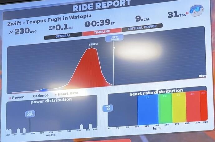

The best part is this cheap ass thing can handle some serious power. Today was only 1600watts but I have hit 1800 on rgt on this bike.
All together if you got a used cycleops and a cheap Walmart bike you can have the full zwift experience for under $500 that can handle serious power. The 1556w pull was seated and the 1592 was standing. As you can see I have no idea how to sprint on a bike to the point that my seated power is as strong as standing.

I would include a link to a YouTube I did with pulls at 1600w but it won’t allow links :person_facepalming:t3:. The pics is to show the bike did take the power.

aint nobody actually doing 1600w with flat pedals. i dont care what dylan johnson says
edit: didnt actually look close enough. still, you can get a h3 for dirt cheap now so need to settle for an original
Is that a challenge? Lol. You are right. I still pop out with spd clips when seated. But all bikes come with those cheap pedals. But for $128 this is lots of fun.

What’s your YouTube channel name or the title of your 1600w pull video on YouTube? Thanks in advance.
Search Kent genesis bohe. The channel is hill160881. The last pull was only 1592w so I rounded up lol.
You’ve got some very explosive power! You’ll probably need road clip-in pedals or double strapped track pedals to hold your wattage. If you shoot new videos, show yourself riding the bike to squelch the disbelievers.
Thanks. I will make sure to get more than one angle next time. I will capture it with obs next time.
