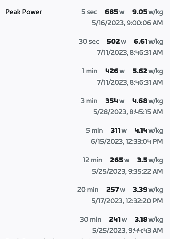

Also if you go to my.zwift.com and click on My Profile and share a screenshot of your power numbers it may be possible to explain your situation. (Example below)
My numbers are an example of a relatively high C category rider. I’ve been expecting to get into B for a while but haven’t made it so far.
