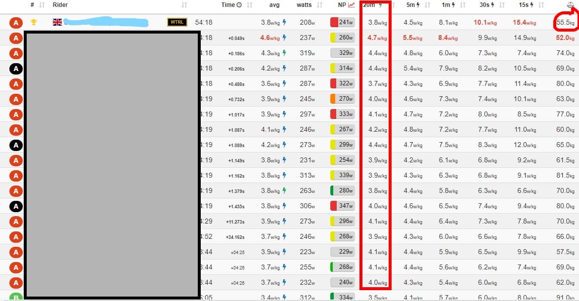

i was originally going to post this the other day to point out how stupid double draft racing is, but i guess it works here. the entire A field from a pen enforcement race including the few people who were dropped:
2nd lightest guy in the race (me) wins on a very flat course (seaside sprint) with the 2nd lowest 20min w/kg, only a guy weighing 25kg more than me managed .1wkg less for 20min. not because i am better at drafting than everyone else, iâm not, but because i did the bare minimum while everyone else did their best to create gaps and drop people. and they would have certainly succeeded in a regular draft race
i think double draft is probably covering up some big faults in this cp category model. i guess theyâll become apparent if community races start adopting it without DD enabled
