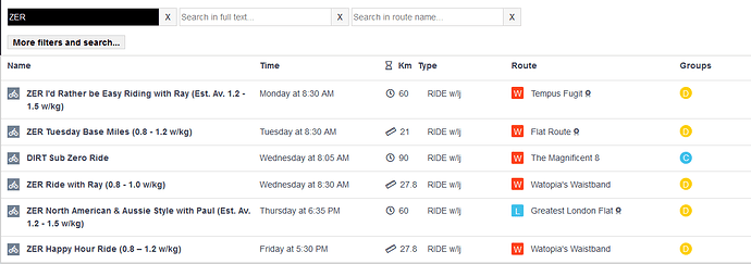

You can look for group rides easily at Events
Below are some examples of using a filter at Zwifthacks to find some possible group rides. To start with, look for “D” rides. Another indicator is “sub” in the title. The groups that follow their advertised pace (not all do) will ride around 2 watts of effort per kilogram of body weight, or 1.5, or 1.2, etc. Obviously, the lower the number, the more suitable it is for people just starting to build cycling strength.
