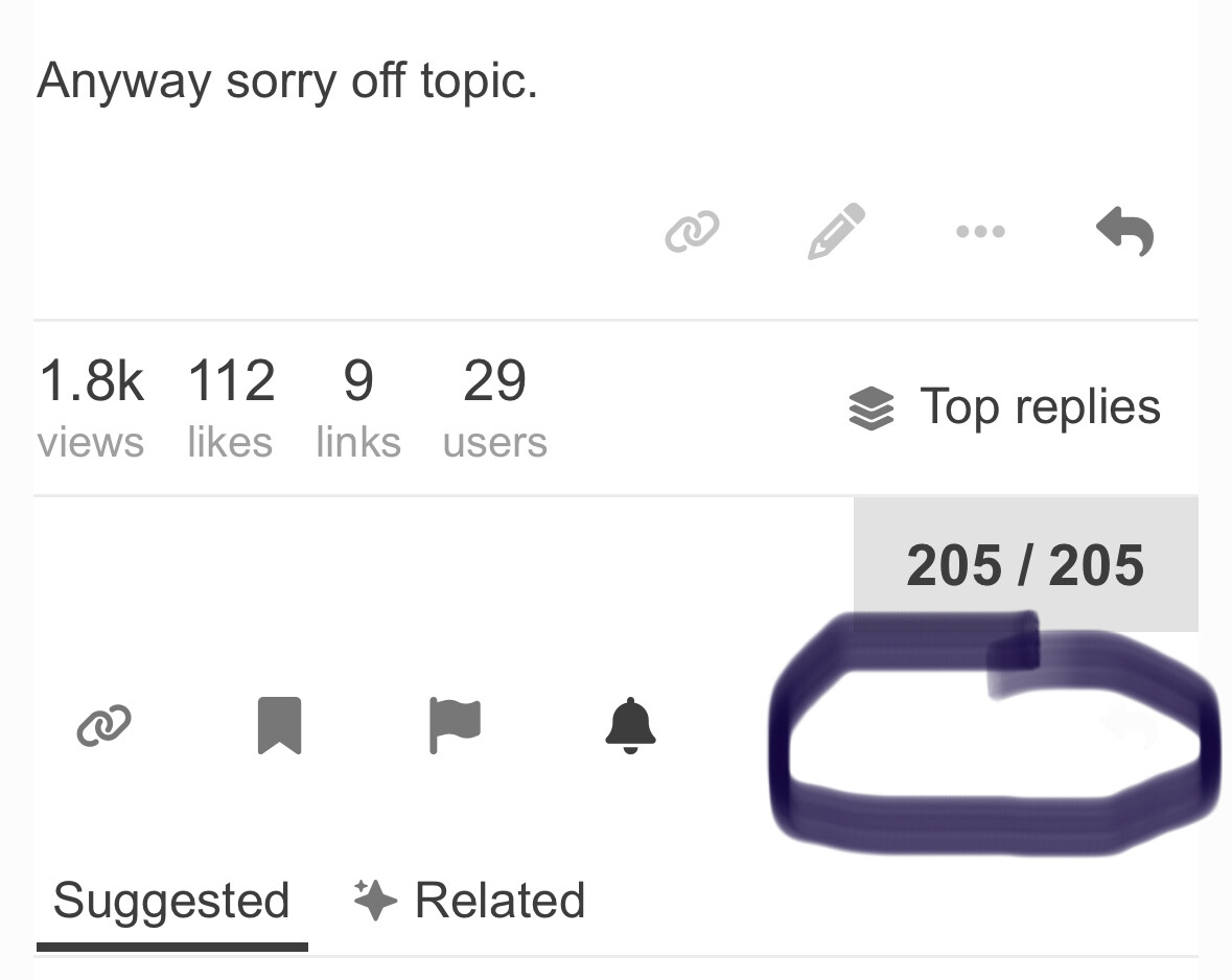

The button is hidden for some reason. If you click on the empty space on the bottom right you will hit the reply to thread button.
Anyway sorry off topic.

Good detective work! Indeed it’s a small hidden region and that works.
