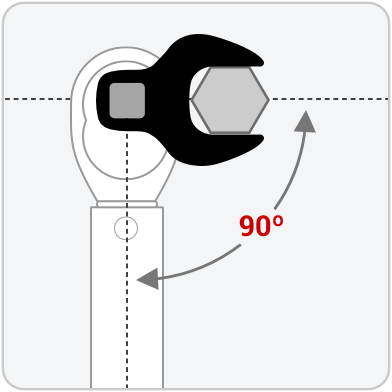

Excellent! When using a crowsfoot extension - it’s important to set its opening 90 degrees to the wrench handle, like this:
This keeps the effective length of the lever arm the same as using a socket type extension (like an 8mm hex socket). This is an overlooked / less-known detail that that affects the wrench’s torque reading.

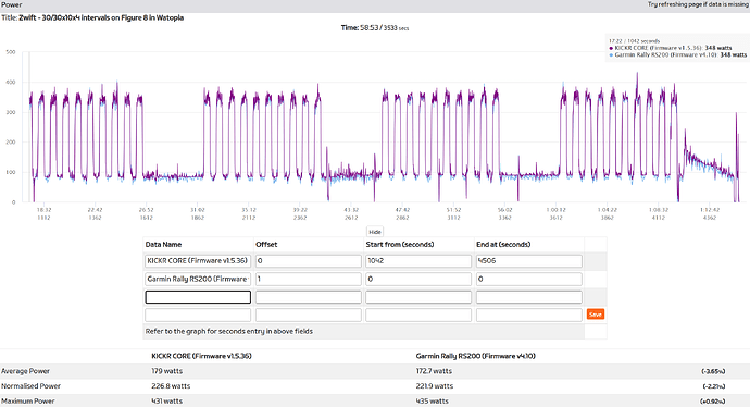

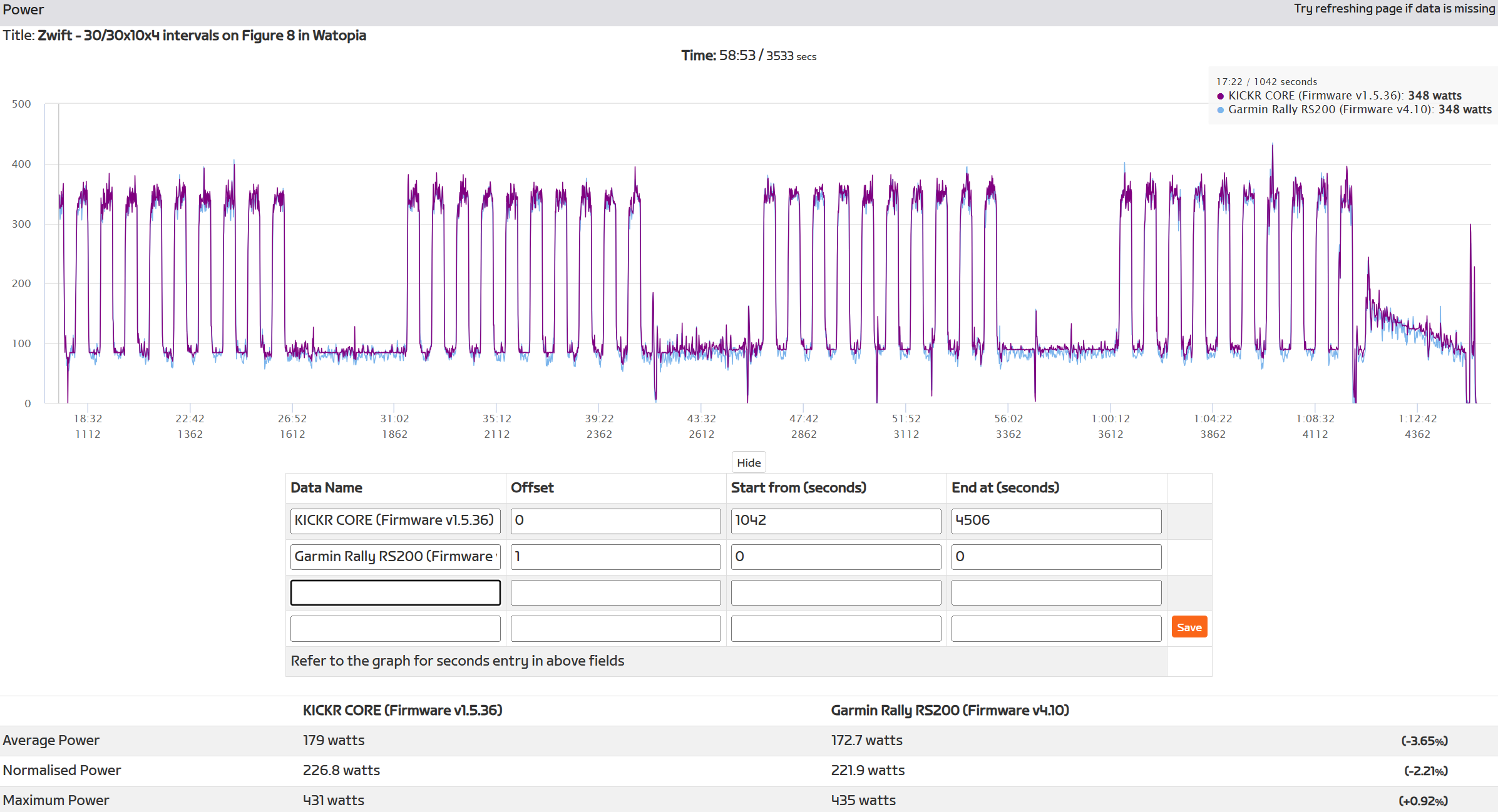

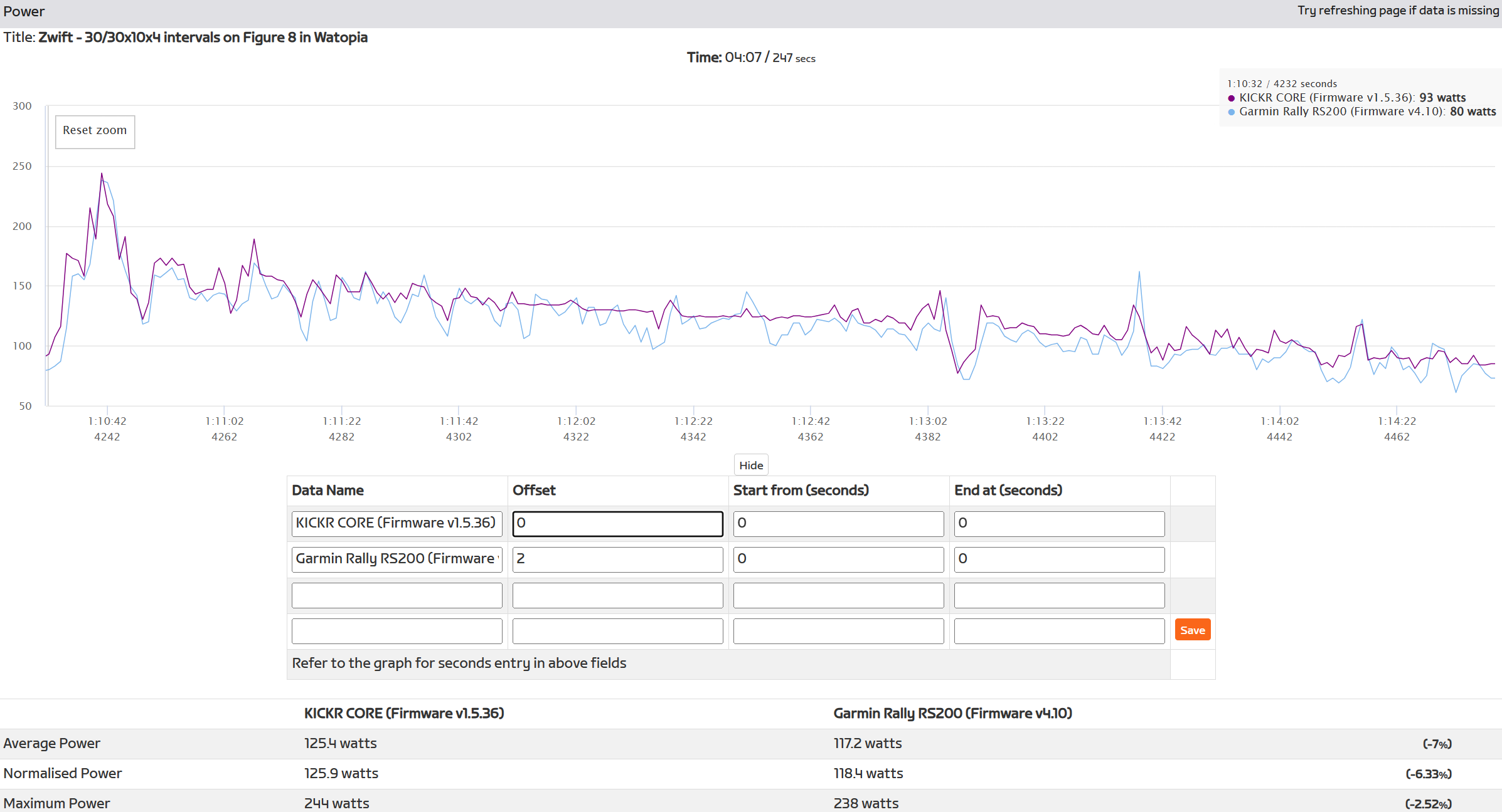

The crowfoot arrived and I got around to another power metre comparison, this time tightening the RS200 pedals to 34 N-m when installing them on the cranks, as recommended by Garmin. I did an intervals session and wasn’t expecting to see much change, but was amazed to see far better alignment between the power measurements of the pedals and the KICKR CORE. The dataset is public on my Zwiftpower page and below is a screenshot. The pedals measured an average power difference of -3.7%, far better than the previous -13% during the same workout. I’ll continue to test, but am happy with this margin of difference. Many thanks for your advice regarding the importance of getting the torque right when installing the pedals on the cranks :slight_smile:

Looking at your graph, the 2 appear to be closer early and seem to deviate more towards the end.
This might indicate a temperature issue.
If it is warm where you Zwift, you might want to use a cooling fan on your trainer.
Regarding grease, I followed Garmin’s recommendation to “Apply a thin layer of grease on the pedal spindle threads”.
I don’t see that in the data, Tim. If you look at the high power intervals periods (about 350 w), the measurements align more-or-less perfectly throughout the session. Also, if measurement drift due to rising temperature occured with the KICKR CORE, we would expect a drop in power readings due to the decrease in resistance, as far as I understand it, both during the low and high power phases. That doesn’t occur. Please correct me if I’m wrong.
Interestingly, though, the KICKR CORE generally reads higher during the soft pedalling between the high intervals, which is especially noticeable during the cooldown at the end (see graph below). Both estimate cadence more-or-less exactly the same during this period. However, the pedals have much more variation in the data, and my impression is that they are providing more accurate measurements during the softest pedal strokes, but that is just a guess.
My first comment was just eyeballing the curve .
I went to the dual recording on ZP and zoomed in.
If you zoom in on the 8-10 min around your first interval, you power meters were about 2.65 % but then the 8-10 min around your last interval, it was 3.8 ish.
The 3rd interval, in isolation was was over 4% off.
Overall, the whole workout was 3.5%.
I’m not sure what can be determined from analysis of 1set and I’m not familiar with your set up.
Not trying to diss you either.
It just appeared to vary more towards the end.
That may not be the case.
Keep up your excellent efforts to improve your data.

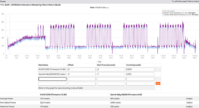

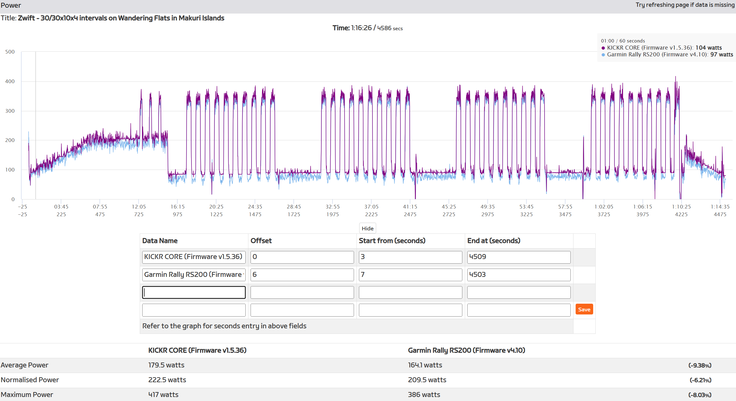

Well, just as I thought the problem may be solved, here it is again. This is the same intervals workout, completed this morning. The pedals differ by an average of -9.4%, which is too much. The data are public on my Zwiftpower page. During the high power efforts (about 350 w), the measurements are closer, within 4 to 6% of each other. During the low power recovery phases (about 90 w), they are much further apart, within 20 to 25% of each other. I can’t see any obvious drift in the KICKR CORE data that would be associated with warming inside the trainer (the KICKR data remain consistently higher than the pedals, by a broadly similar margin). I have a new pair of Assioma pedals arriving at some point, so I’ll compare them with the KICKR when they arrive. Other than that, I’m not sure what else could be done.

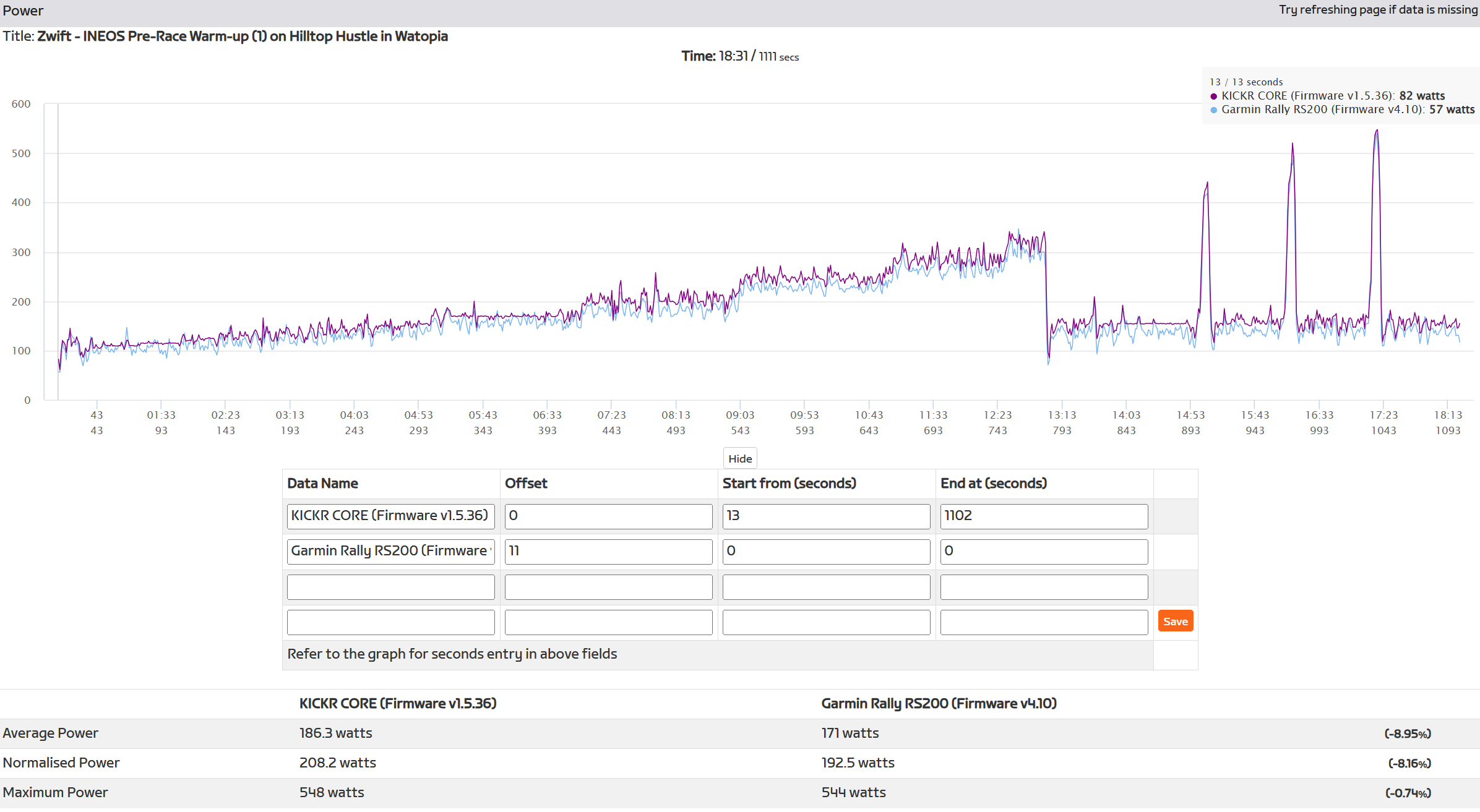

Another test here, with the INEOS Pre-Race Warm-up workout (18 mins). The RS200 pedals average -9% compared to the KICKR CORE.
