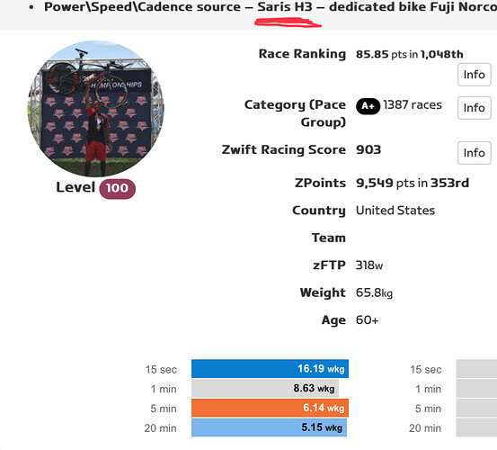

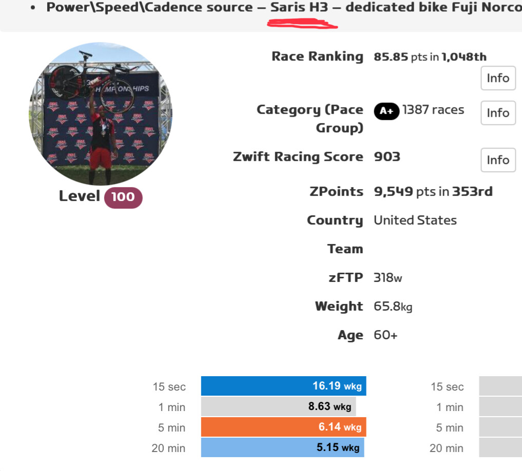

Dual also isn’t the answer for the non-race situations like KOMs and Segments, as it would raise the cost barrier just to get involved. The idea above of restricting those lists to smart trainers/power pedals/cranks would be good enough. (So long as they don’t clamp down as hard as they do on those white lists for elite racing, where my H3 isn’t allowed :smiley: )
Wonder why your H3 is not allowed :roll_eyes:

The problem is that many can be manipulated during calibration, there among the H3, and that is what we see from that 60+ gentleman posted.

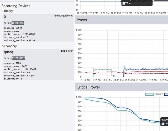

May I ask where do you get the equipment information shown on the left side. Especially the “calibration” field. We tried to fish that out of fit files to no awail. Could not even confirm if that information is transmitted.
Not going to disagree–and tbc I’m not complaining about my H3 not being included in elite racing. If I was elite, I’d get something else :smiley: It works for what I want it to do, and it’s accurate when calibrated. My point about KOMs and Sprints and Segments was just that if they were to pay attention to those and white list/black list trainers, those shouldn’t be taken so seriously as to exclude legitimate smart trainers, even ones not included for elite racing.
That would be the https://dualrecording.tpvirtualhub.com/

My point is. The equipment sends out hardware/software info, but to the device recording.
If I take a fit from my garmin, it would say Edge 530 and nothing more
If I take a strava fit, it would say nothing
BUT. Zwift can chose to store and use this info
That would tell if your kickr is up to date
It would tell if your trainer is PM controlled etc.
There is a lot of tools Zwift could use if they were interested
interesting. What we tried to find out is the slope factor set on power meters. If this information even leave the PM. We know trainers report if they are PM controlled and this information can be recorded but as you say most platforms and devices simply ignore it.
“calibration” shown in above web page may not be the slope but the TPV calibration outcome. I will test it tomorrow.
https://www.fitfileviewer.com/ on the other hand shows known devices and their calibration factor but I never seen anything other than “500”.
For example pink powermeter has a slope of -6%. Black one is 0%
Hard to tell from these fields.
