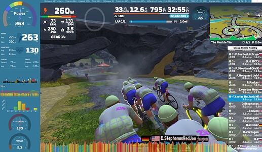

You can connect the Zwift Play directly to Zwift, just like with the Kickr V6, or alternatively, connect it to the QZ App. Currently, I have the Zwift Play connected to Zwift. The app adjusts resistance dynamically based on a virtual chainring and cassette setup on the Qz App. As shown in the screenshot below, it even displays the Gear no. in Zwift, replicating the experience of using the Kickr V6.
Zwift Play works seamlessly with all its features, just as it was designed to.
Note: If you’re using an iPhone, be sure to get the latest beta version from Roberto, as the one in the App Store is outdated.
