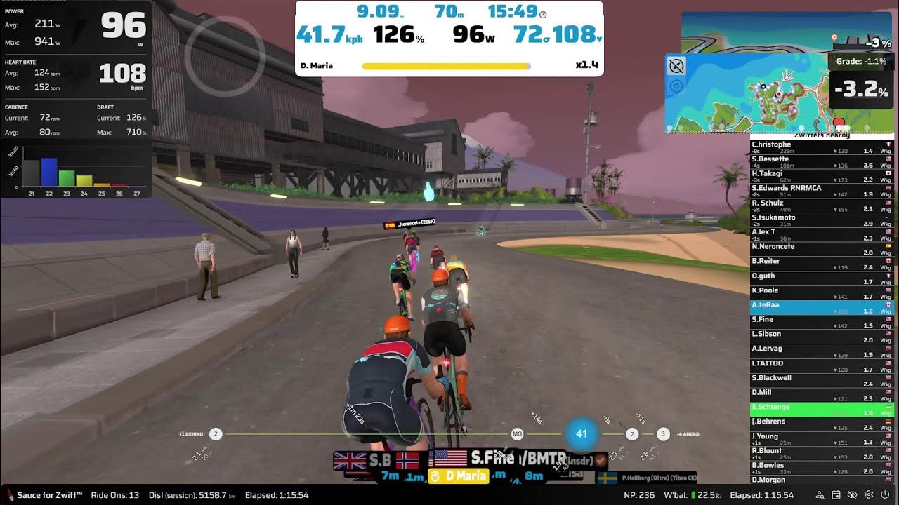

It wasn’t a high-speed ejection but moving backwards through the pack fairly quickly. It was with Coco so yes most were still soft-pedaling the descent. Seems that the elimination of supertuck when receiving any draft has made it so you never ever get to fully recover. A comment previously stated that double draft in the pack at high speeds is a greater benefit than super tuck, so it would be reasonable to assume it would keep you in the pack with people soft-pedaling around you. But apparently that’s not the case.
You should try to get a video of it happening so David can understand. Here’s my example of it not happening. 7 seconds of zero watts at 64 km/hr and not losing an inch to the PP right in front of me.
