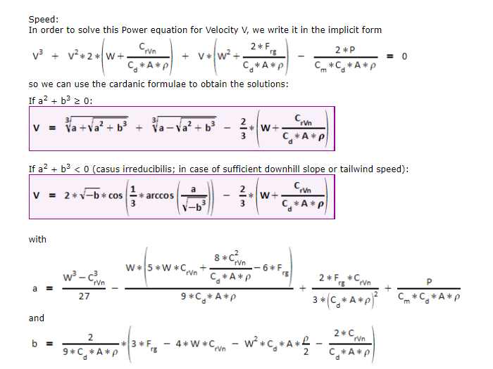

Calculating Speed from power is a complex calculation.
Zwift probably use something like this. Bicycle Speed (Velocity) And Power Calculator

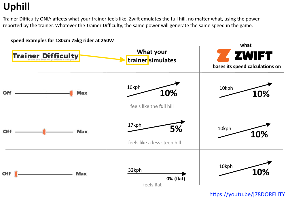

Trainer difficulty only affects the trainer. Ride up a 10% gradient at halfway slider, and the trainer will be told to emulate a 5% gradient.
As far as the game is concerned, you’re still riding up a 10%.
So whatever your slider is set at, if you’re doing 250W Zwift uses that to calculate speed up a 10% gradient.
The only difference is that your trainer makes it feel easier or harder, and that can in turn make it easier or harder for you to put out power (most people find it’s easier to apply power when the resisting force is greater).
Well stated. The trainer receives a slope/resistance that’s half of the one displayed, but Zwift still calculates output speed with the full slope.

I did a diagram.
That graphic should be in a sticky message at the top of the forum. Lots o’ confused people asking about this.
Great job.
Now make one for descents!
Done. :smiley:

Are you certain about the last column for descents? I was under the impression that the 50% factor extended to the simulated speed calculations as well.
I thought otherwise. It’s not what Shane’s saying in his video, as far as I understood it.
There is an example where he U-turns on the KOM - Zwift says 7% and his Wahoo says 3.5%; but he’s descending at 40-50kph at the bottom. I don’t know what Shane weighs, but that doesn’t seem like a 3.5% speed to me. Then he does it at half Trainer Difficulty and still hits 50+kph.
Indeed, it would make no sense for Zwift to make people slower on descents when they don’t make people slower or faster on ascents.
I thought the point was the same as with the 50% factor in general: to have the rider make more of an effort going downhill.
The main reason I’ve been wondering about this is because the ascent and descent numbers in the ride data don’t match when riding a loop, the ascent is always bigger but the factor varies. (Of course there can be other explanations, such as different thresholds for what counts as a climb vs a descent.)
It’s not about making the rider make more of an effort, really. Lowering trainer difficulty makes your trainer simulate less of a hill. In turn that means you have more resistance to push against, so can make more of an effort.
Trying to put down power on a 10% downhill is harder than doing it on a 2% downhill or on the flat.

The slider is just there to change what the trainer does the hill in Zwift never change, only the amount of resistive force that your trainer apply.
To calculate speed Zwift use Power, incline , mass and a bunch of other variables. The incline is as it is defined in the route profile. So Zwift don’t care how you generate the power you can have a lot of resistance and low rpm or high rpm and low resistance, it is your problem how you generate the power.
