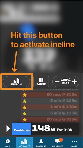

I was having problems with my Kickr Bike Shift reporting low wattage and thought it was broken. Turns out that I had accidentally entered an incline mode in the Zwift companion app and somehow adjusted that a bit. After changing the incline value back to normal and touching the button, it reverted back to showing ERG ON - and now everything works again.
Sharing this in case it might help someone else.
