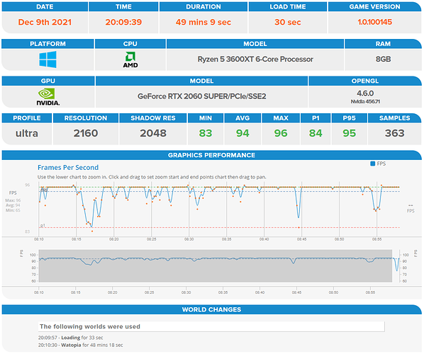

Here’s a race tonight on Watopia. Same rig, similar numbers in the bunch I was with throughout (if not more). The race started at 8.17pm, which is where the low of 83fps occurred.
Obviously far more consistent (95fps is the cap at my monitor’s refresh rate) and effectively 50% better performance on average. Ridiculous.
Did a bit of GPU load testing tonight. TL;DR, when the CPU bottleneck is eliminated/not a factor, an RTX 2060 Super isn’t strong enough for a consistent 60fps on Yumezi.

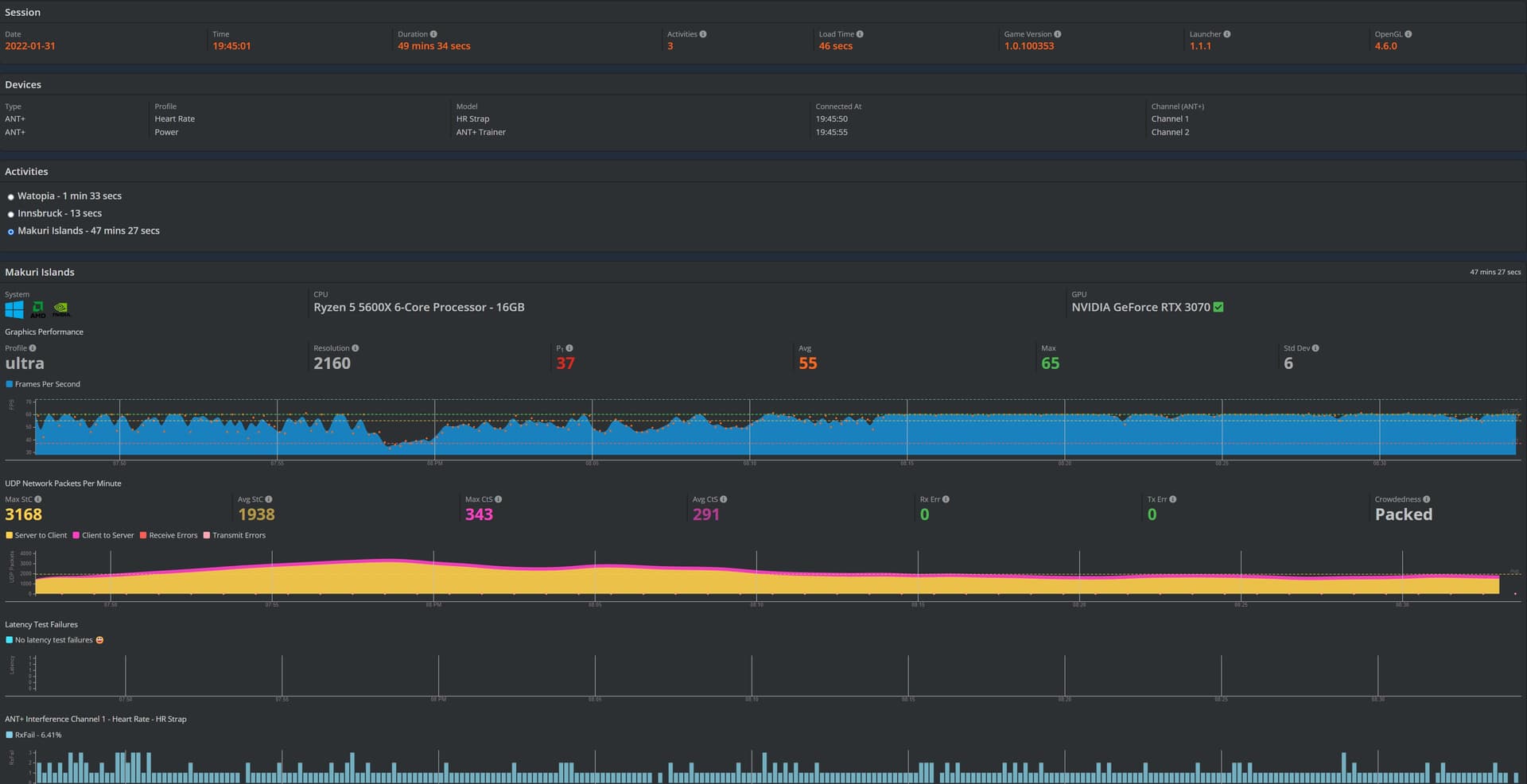

This weekend updated from a 3600XT with a GTX 1070 to a 5600X with a 3070 OC.
Im hoping to see improvements tonight at Makuri and with the Jungle dust.
You’ll see a big jump up in frame rates on Neokyo in particular, but it’ll still drop below 60fps in some busy spots or in events. The graphics card won’t actually help much I’m afraid, your 1070 was already plenty strong enough for all but the most dense areas of foliage.
mind boggling. your 3070 gets 55fps avg, my 1660 gets 40fps avg. seems like they should use some of those idle CPU cores…
As I said, it’s not the GPU which is struggling. It’s probably down at something daft like 40% utilisation. Makuri is massively CPU limited for no apparent reason, and even your new 5600X can’t feed the 3070 fast enough to maintain 60fps. You’d have those same lows if you swapped your 1070 back in, or bought a 3090. CPU is the problem when it’s busy with other riders nearby. It’s like this everywhere on Zwift, but Makuri is particularly bad, hence why this thread exists.
