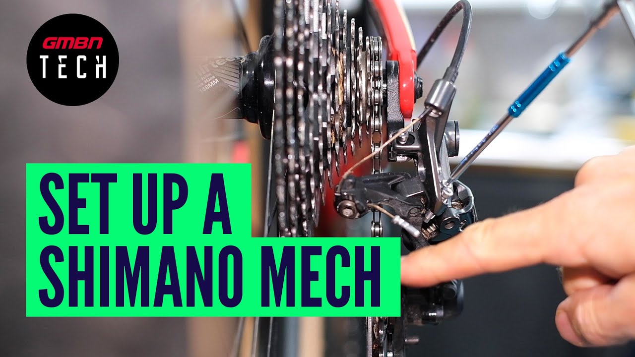

Adjusting the rear derailleur isn’t too hard and it’s a good skill to have. I learnt off YouTube, just scanning through this seems like a decent video.
I limit myself to the basic adjustment (low/high level screws, barrel adjuster etc), if it looks bent and or damaged then I’d take it to a bike shop.
