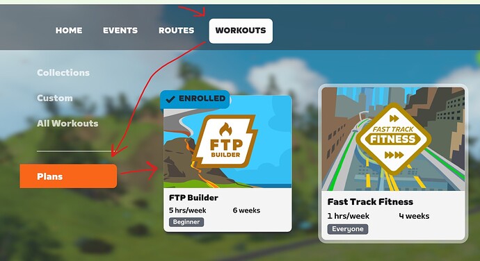

FTP Builder and Build Me Up are both popular plans on Zwift if you want a canned plan that leaves you to figure out some stuff on your own (like should I work out or rest on a given day).

Check out the workout plans in zwift to help find what you are looking for. There is a FTP builder plan there that I just started that is 4hrs per week. After you do a workout, do a 1hr pacer ride at a pace that keeps in you z2 as much as possible. That way you get the structured training you are looking for and you’ll earn plenty of drops for new frames / wheels / upgrades for future racing.
