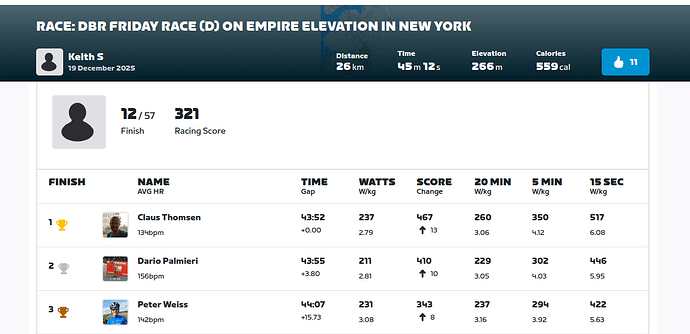

Yesterday I raced in Category D in the 4.00pm (GMT) DBR Friday Race on Empire Elevation (activity 2032150554951565312). The race was category enforced.
I see on Zwift Power that the podium position riders all have ZRS above 350 which was the maximum for Category D. 1st = 467 ZRS, 2nd = 410 and 3rd = 379.
How is this possible?
1st and 2nd had big increases in ZRS since their last race, but not due to yesterday’s race. I can only presume both set a new 5min best in a zwift session that doesn’t show in zwiftpower, such as a solo erg workout.
But then I’d normally expect yesterday’s result to show approx +130 and +70 in the ZRS plugin for zwiftpower, however they only show +13 and +8.
Is ZRS plugin now not showing increases due to seed score (5min) changes and only changes from finish positions? :thinking:
I believe they did set new 90 day pbs during the race.
Yes I think this week Zwift made a change where in race pb increases don’t show within the score movement result. Score movement only shows the actual race result change. So 13 and 10 are result movement and probably include a podium bonus, if one is still in use.
( I think there are the odd score movements which differ slightly to show a move or increase to floor ? )
I got ahead of myself thinking that the ZRS were pre-race scores, obviously they’re not! I do not however believe that you gain 117 ZRS for a win (in the scenario where #1 goes from 350 to 467 for example).
But anyway, this is all specualtion as the results show ZRS changes of +13 for #1 +10 for #2 so they were DEFINITELY above 350 before the race - see attached screenshot. Strangely, that also shows #3 as having ended the race with 343 so within the Category limits while on Zwift Power it’s 379 so with a change of +8 they started the race at 371 (unless they did something after the race that increased racing score).
This is likely not the case. The winner did 4.1 w/kg for 5 min, before the race he hadn’t done more than 3.6 since before the summer. This would give him a new seed score during the race, not before it, and caused his score to jump well above the limits.
Unfortunately the system doesn’t show these new seed scores very well so you have to do some digging in situations like this.
