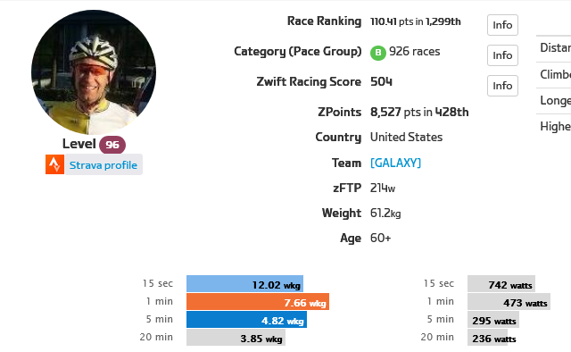

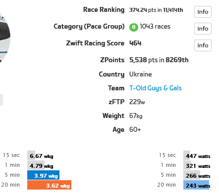

And there’s this. I have a ZRS of 464 with a profile like this:
Tell me, how do I compete with that kind of short game. I am a Diesel, always have been and will continue to be so. Getting penned with this kind of power is nonsensical. I don’t win races, sh*t I rarely place in anything that means anything. With the current system in place, racing is about as fun as it was before CE and the lower cats were rife with sandbaggers from the A and B pens. For a short time when ZRS started, racing was fun with packed pelotons all racing hard. That is not the case anymore; five minutes into a race and we’re all strung out. ZRS 3.0 is not an improvement over anything.
@Mark_Crane_TOG_G_65y work on Top line power 1 min 15 sec, see your on wrong side of the power numbers , So work on it.
Dude, I’m 68. That ship has sailed. As I said in my post, I’m a Diesel, always have been and always will. I work on it in workouts and stuff but I’m NEVER going to be putting down more than about 7.5w/kg for 15 or more than 6.0 for 60. Ever.
