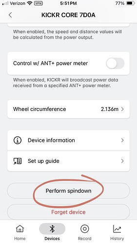

I have a Kickr Core, the trainer spec-wise a step below the v5/v6 Kickr. The normal spin down activation is located here for me:
I do recall reading somewhere, though, that the normal spin down is only available for the Core, and has been disabled (inexplicably?) for the Kickr v6.
Edit:
Found it. From Wahoo’s website about auto calibration:
“Do I still need to do a regular spindown calibration?
No - a regular spindown is no longer needed because the automatic calibration is always on. Additionally, regular spindowns are no longer possible with these devices (except CORE). If you have concerns, you can always ensure that coast for a few seconds in between warmup and your workout / ride / race.”
