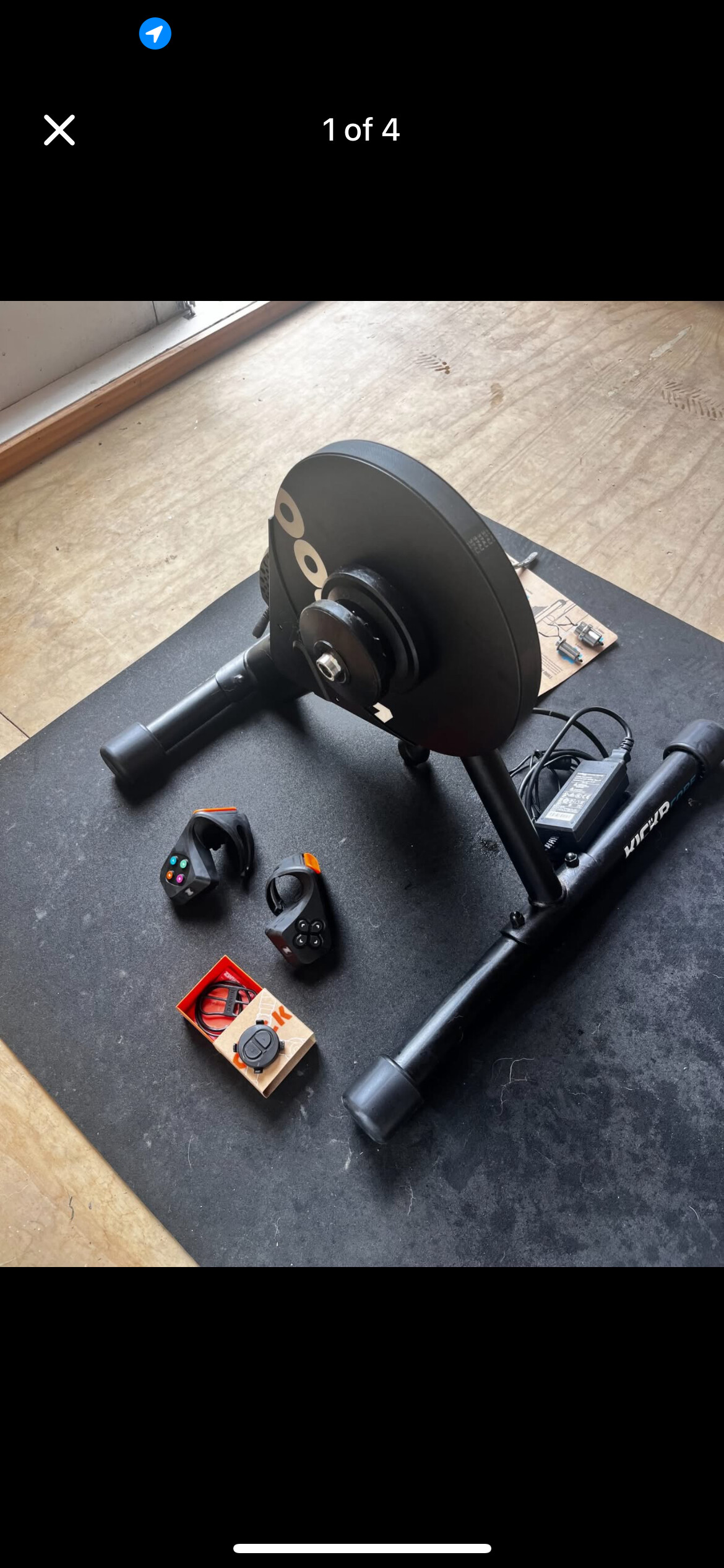

Hi, Guys I’m new the world of Cycling and Zwift and have purchased a used Wahoo Kickr Core with V1 Cog. I’ve mounted a Scott Speedster 40 - 9 Speed to the trainer. It all works ok but when under a bit of load (E.g standing up) it feels like it skips a tooth? I’ve checked derailleur adjustment it looks pretty well inline with the cog so I’m not sure what else to do? Chain, New Cog etc? Thanks in advance!
